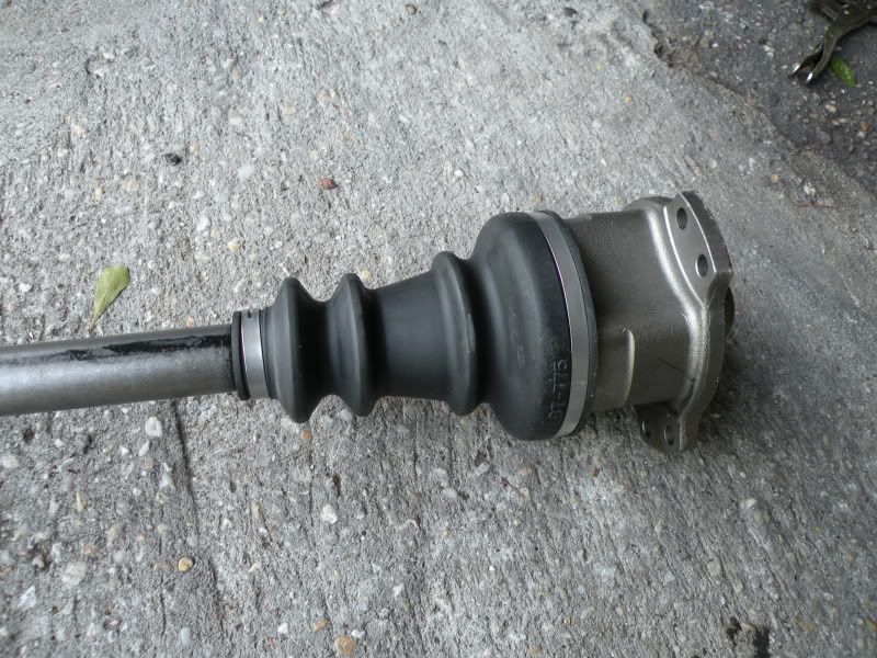

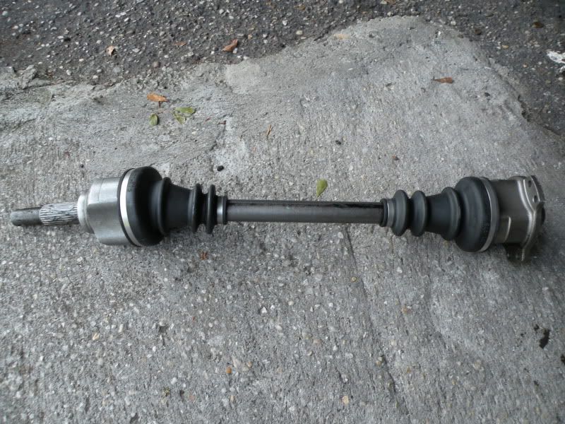

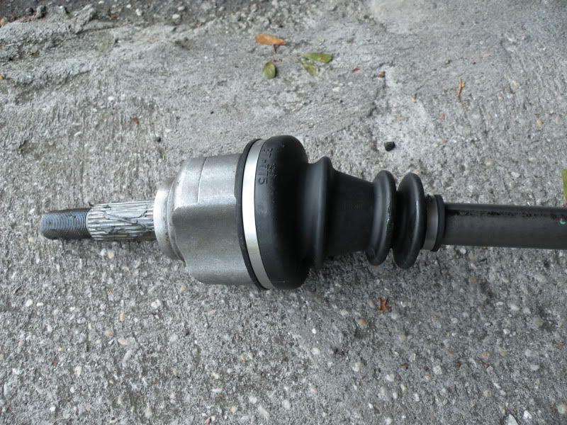

I bought some remans from oreillys
They redesign the boots to where they dont make contact with each other when the cars are lowered
No issues with mine at all

those are some nice looking axles ^^

That's what I'm rocking too. @#%k AdvancedZone Boys.

http://i14.photobucket.com/albums/a3...1/559dba0a.jpg
As you can see, my boot is done. luckily, i kept my old axles which i will be replacing today.
I don't have money right now to get it replaced but is it ok to drive for a short distance?
i can hear clunking noises

^you're fine. It will just make a mess. Just get them replaced when you have time.
My brothers been driving on blown axles in his FWD ford probe for over 3 years haha
There were some spacers posted in the roll center thread that should help with this issue on very low cars. They space the axles away from the diff so there is not as much stress on them. Not sure where to get them though.
