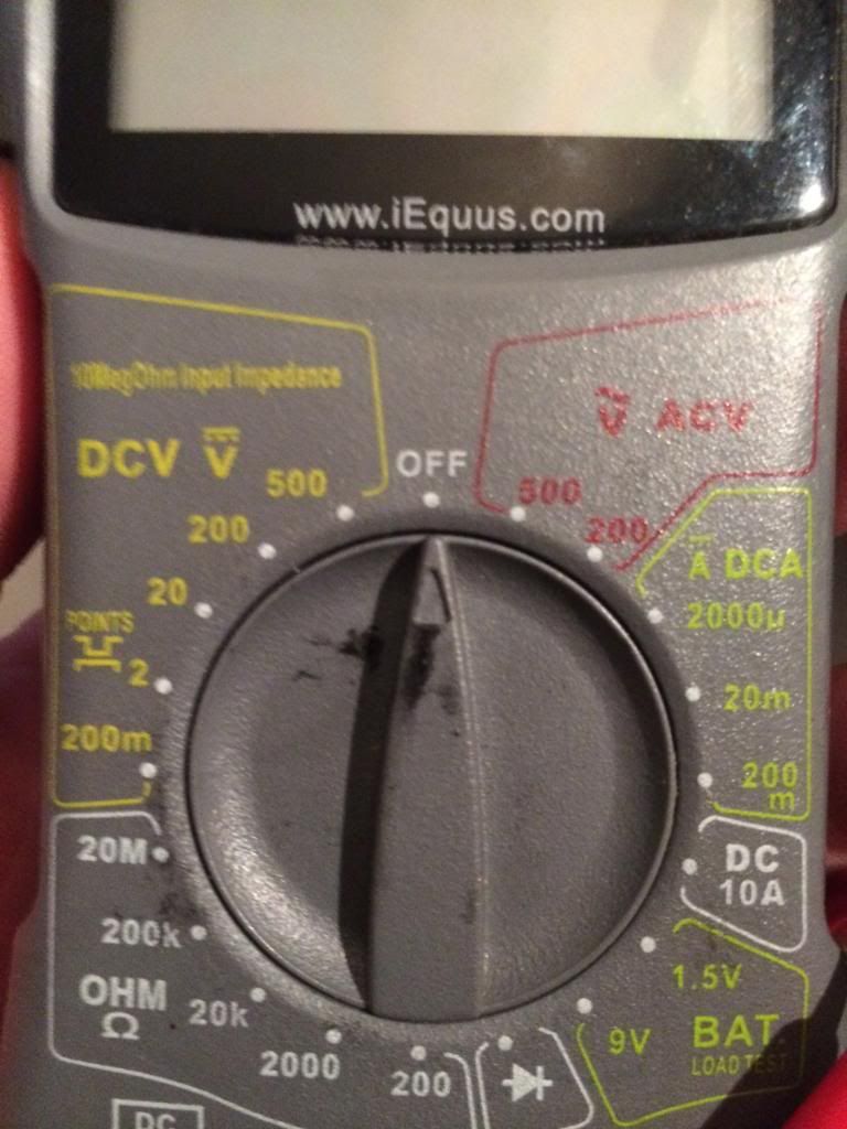

how would i go about checking if the plug for the injector has the right amount of power coming through the wires to the injector?
i have this but have no idea how to use it?

Okay so I checked the injector harness and it's reading like 5-6 volts. The rest is reading 11-12 volts.
How do I check to see if it's the ecu or wiring harness that is bad? Don't want to buy either one if its not be the issue.
