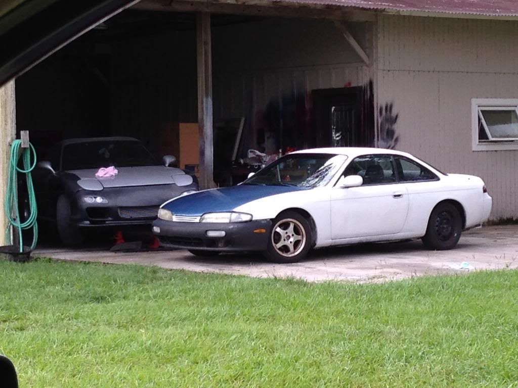

Here is some of my old s14 projects/cars (all started 4x4/4 lug/slow)
My first 240sx, Ka-->Sr
My RB car, built and painted from a shell by me.
I took a break from 240's to get an rx7 where i wanted it...until i found a cheap car that needed a ton of work. I put my Fd on hold.

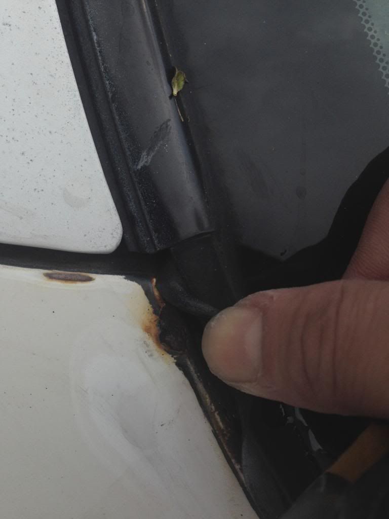

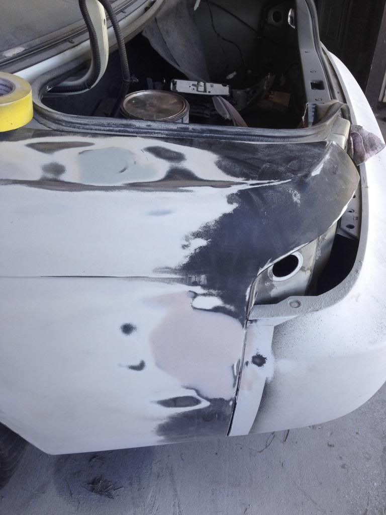

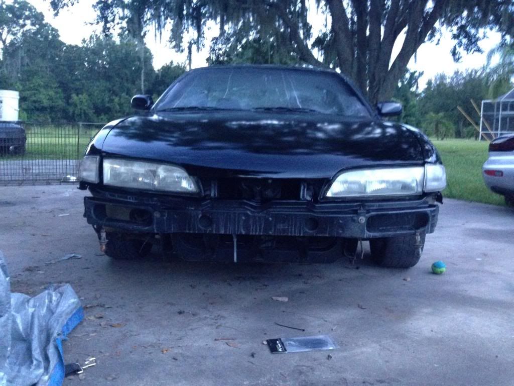

---Ka/4 lug/lowering springs/pretty much stock/broken window/rust/bent core support/and needed body work---
Lots of this under trim and near fender wells..
Took care of rust the first day and started on body work ... everywhere
(just a sample)
Some primer was laying around i used to cover the chassis for a solid coat and get rid of the blotchy rattle can primer so it wouldn't react with the base coat reducer.
(good amount of body work here)

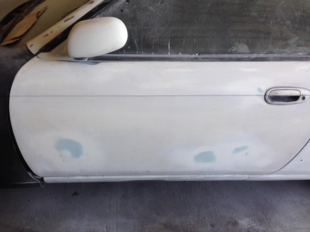

Just a bit of wet sanding and a little buffing, thanks.

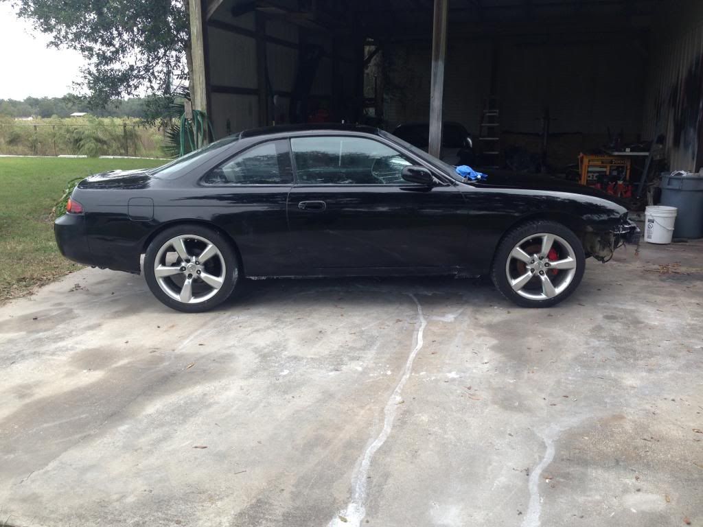

Here it is a day or two after paint, not really bolted together.

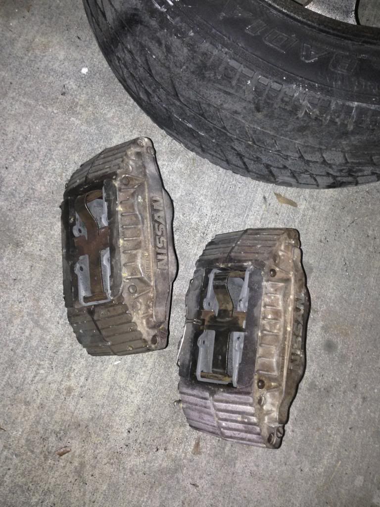

I picked up some five lug and z brakes too, very necessary upgrades for any s-chassis.
I rebuilt them too..
I got some wheels for the hub conversion and started wet sanding the clear.
I obviously wasn't going ka with this one, more updates to come tomm, its coming along pretty nicely at this point. Just looking for any affordable turbo motor...

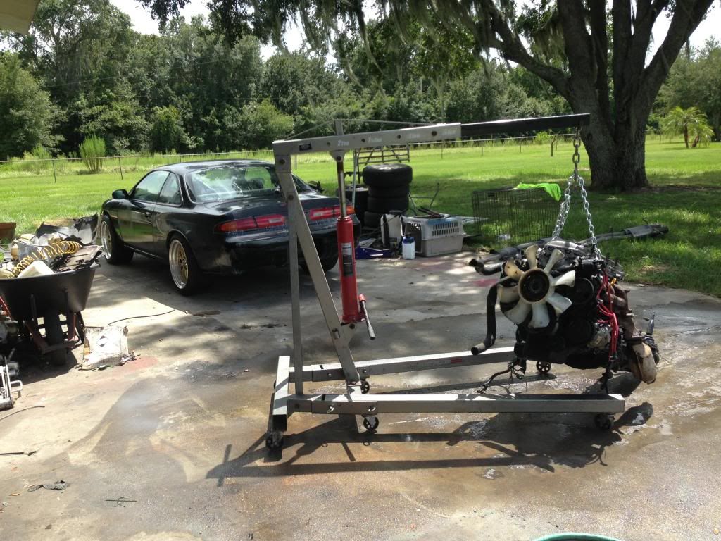

This post is all about the engine
I picked up an sr that had no starter but was sworn to run, i got a starter 2 days later and it was fubar
They all looked like this, compression was like 20-80 across the board
I sold the turbo and found Cp's and Eagles for cheap
Wanted to get fresh everything because of how beat up the pistons were
Pumps
Oem gasket kit
Hot tanked/decked/arp's
Theres more ill update with on the chassis and aero next post

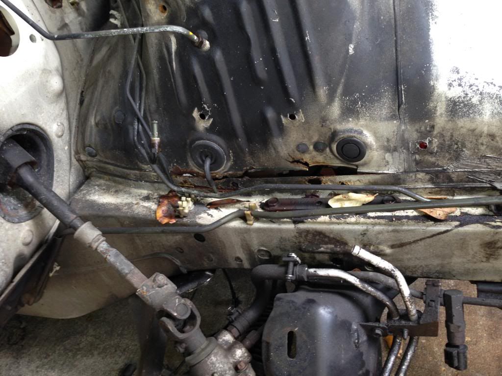

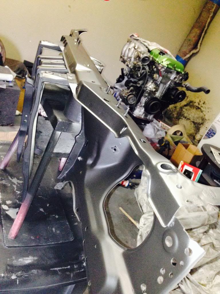

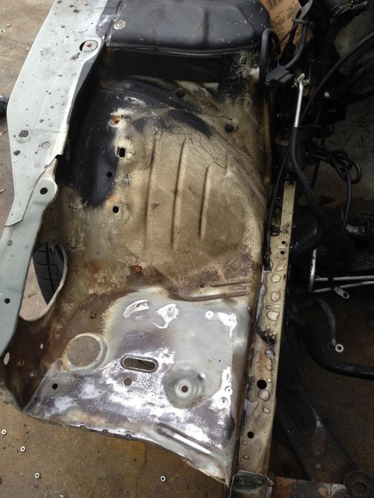

So i don't really like the idea of a bent core support with a chassis thats getting a painted engine bay so it was drilled out and i found a pretty fresh one to bolt up to have a mint front end.
Let me start off by saying i wasn't a fan of the xxr's and went with some 35th anniversary z wheels to make it look more stock.
This is the drilled out battery tray and new core support all rusted up
cleaned that up
Heres a test fit before i painted it to protect it from any humidity or surface rust
2k/epoxy hybrid primer

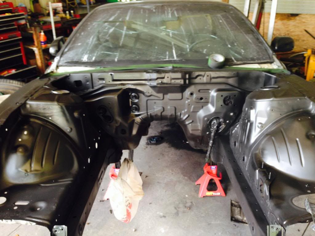

After stripping the bay, fixing this bad rust spot and waiting for the seam sealer to dry, i primed it with the same paint as well.
Gross
This is probably the third or fourth time i have done this and it is killer getting every last tab and clip out of the bay and sanding old greasy oil spots the pressure washer didn't hit.. but it sure is worth it.

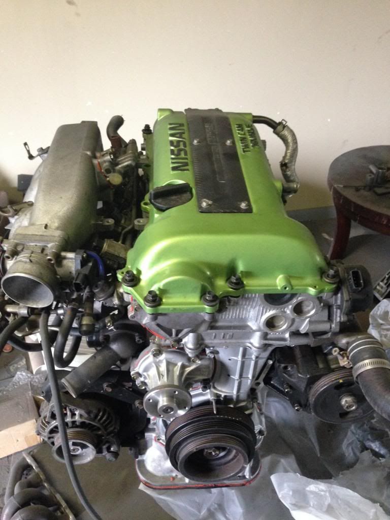

This color is the crazy looking scion cement grey metallic paint i had laying around, i figured it would make the nsx green valve cover pop.

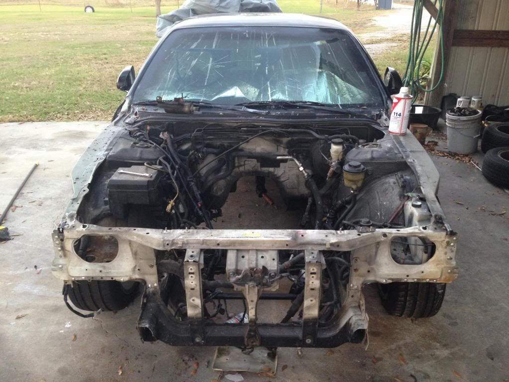

Heres a quick test fit before tranny is on, the panels were taken back off and the motor pulled. A few spots on the chassis need to have a bolt extractor/ helicoil so the panels were pulled as well.
