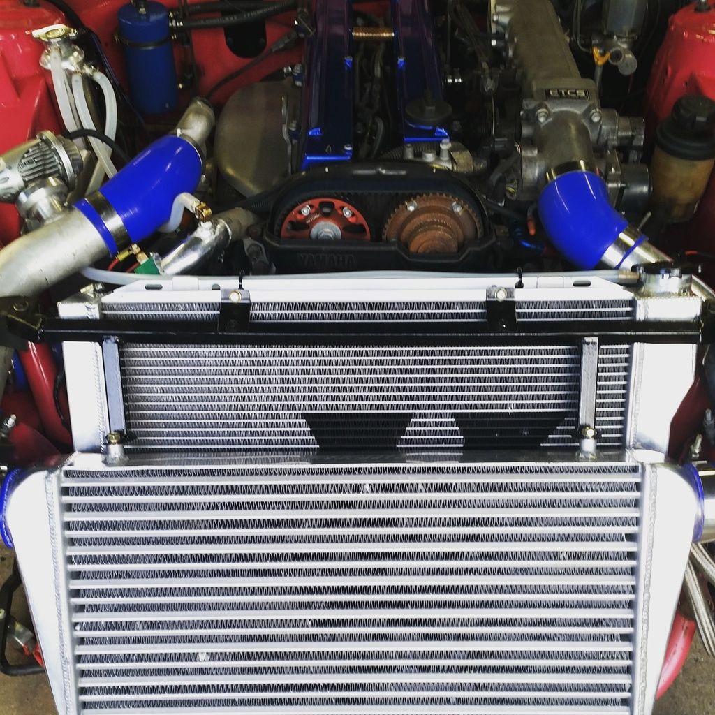

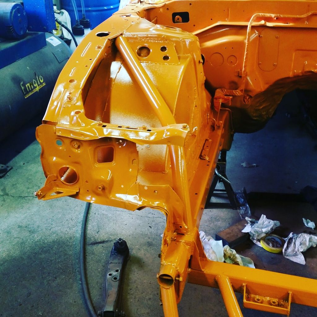

I havent updated this in a while so ill give a little run down of some off season upgrades getting ready for the 2017 competition season. After 2016 the car was working well other than a few minor issues so i really didnt change a whole lot just addressed some issues and fixed the damage from my crash at the last competition of the year.
The last 2 seasons i have been running offset rack spacers in combination with my in house made lower control arms. It made for an great butter smooth steering feel but they are very hard on racks. Since i junked my crossmember in the crash i decided to move the rack forward 1 inch to take care of steering bind problems.
I also had some issues with drivetrain vibrations last year so i rebuilt my dog box. It was in pretty good shape just had to replace the 4th gear face plate. The driveshaft shop hooked me up with a sweet deal on a new aluminum driveshaft as well. They balance their shafts up to 10,000 rpm which is a lot more in depth than any of your local shops do.
I also went through the factory vvti 1j harness and removed every unnecessary plug and wire on the whole harness cutting the amount of wires in half.
Ordered a full new kit repainted that as well as laid down some fresh pain in the engine bay. Yes i am aware that their is some orange peel this was the first time i attempted to paint anything and literally have no idea what im doing with a paint gun so it didnt turn out half bad!
I have worked with Neo Motorsport for several years now but for 2017 they really are helping me out with expenses and product. They sent me one of their 4 piston front big brake kits. I was extremely impressed with the quality of their kit. The performance of their suspension is second to none as well. If any one needs a hookup on coilovers or brakes shoot me a PM i can get you a deal!
While i was getting the car buttoned up my boys over at PRL Motorsports were giving my engine a refresh. Cp Carrillo and Brian Crower came onto my team for this year and hooked me up with some internals. After 2 full seasons the engine was still in great shape. New rings bearings and a good cleaning and it went back together. We upgraded the springs and retainers as well as some oversized valves and 272 cams. Should dial the car in at about 700hp to the wheels. PRL Motorsports engine builds and tuning is second to none. For a full race engine to look that new after 2 seasons is unheard of especially with my always on the limiter driving style!
Car is being dynoed this week and after that it should be ready to roll. It will be going to canada to get a full wrap from Neo Motorsport before the season starts. 2017 will be my last year in an s13. I have a wild build in the works for 2018. I am hoping to make my pro debut here in the U.S for 2018 and this car will be one of the wildest in the pro field! I cant wait to get the build started!
