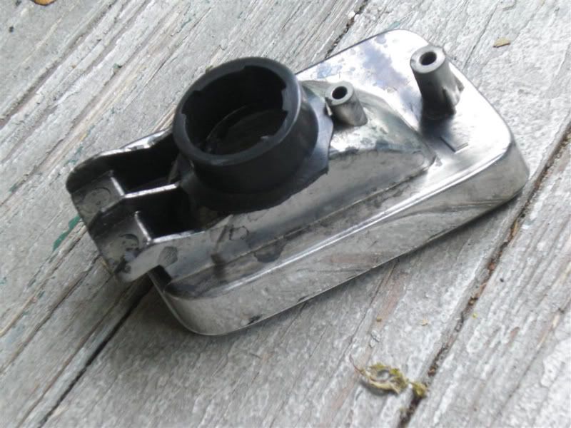

I wanted the position lights to act as turn signals as well. 1157 are dual-filament (turn signals) and there are alot of different options for LED bulbs.
cut housing:
amputated 1157 bulb holder attached with epoxy:
they are pretty bright, and i'm not even using SMD style LED bulbs, just cheap ones like this:

Originally Posted by 1990 s13 View Post
cant get the dmax ones anymore? =(
so wait with the 194 bulbs work for position and turn signals at it blinked fast or just turn signals
DMAX lights are still available. I'd recommend going that route if you want an easy install.
OEM position lights will not perfectly work as turn signals (like OEM). Reason being is because they are not dual filament or in easier terms, "dual function".
However, a load resistor will help alleviate the issue. Problem is mounting the resistor to a spot where it will not burn anything OR get water and or dirt on it.
So all in all, if you want OEM, get yourself the turn signals as well. Until this day, I still haven't fixed my position lights. I plan on getting the turn signals very soon.

think this would be an adequate fix ? I couldn't find the factory wattage for a 89 turn signal, nor the wattage of the bulb Dmax uses so without that information to compare and use to find the proper resistor this is what Google found for me.
Yes, and that is the very resistor needed. However, you need to find some place to mount it. Resistors get very hot which can ruin paint/melt plastic and since the wiring is near the wheel wells, it can get wet or dirty.
Also, you probably have the DMAX ones that aren't dual filament. There are two models that they put out. One can serve as dual function and the other is just like the OEM position light.
Ding-Ding! You're correct! DMAX sells two models for the 180SX Kouki styled position lights, make sure you're getting the correct one.
And if you have the correct one (two bulb locations per one housing) DON'T use the supplied LED from DMAX if you do not want the rapid/hyper blinking/flashing.. Just stick an appropriately sized automotive incandescent bulb in there and done!
