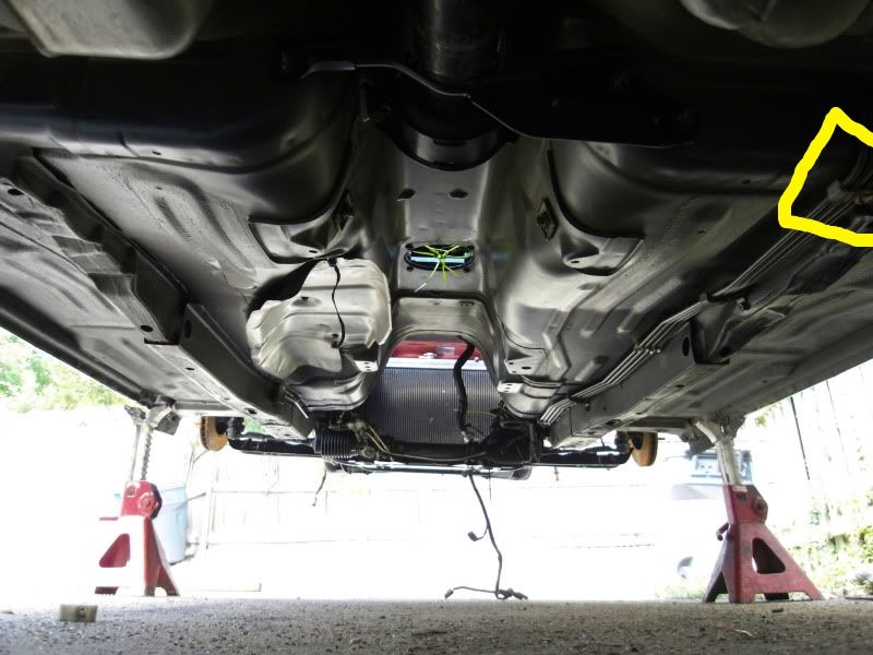

Hello everyone, before I start I did want to say I tried searching but kept getting a page saying Fatal Error so Im guessing the search is having some issues today. Anyways, I was driving the other day and completely lost my brake pedal. Went to find the leak and all the way back to where the gas tank is the hard line that sits in the holder has blew out from the classic east coast rust lol (living near the beach doesnt help). Anyways I want to replace the lines maybe even the gas lines with Stainless Steel or Steel Braided. Is there anyone that sells a kit to do this or is this something that I would have to do myself. If anyone has any tips or a link they could send me I would greatly appreciate it. This is not my picture but you can get a idea of where it broke.
I would like to replace all the lines if possible... Thanks

You could possibly get replacements through Nissan for the hardline sections, or if you wanted braided you would want to measure the overall length of each line, and the fitting size, then go to a local hydraulic line shop and see if they can build out what you need.
That or you could purchase sticks of universal brake hardline, and bend them to fit, then flare the ends and put the appropriate fittings on.
