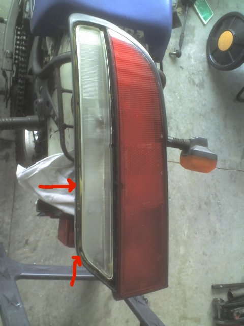

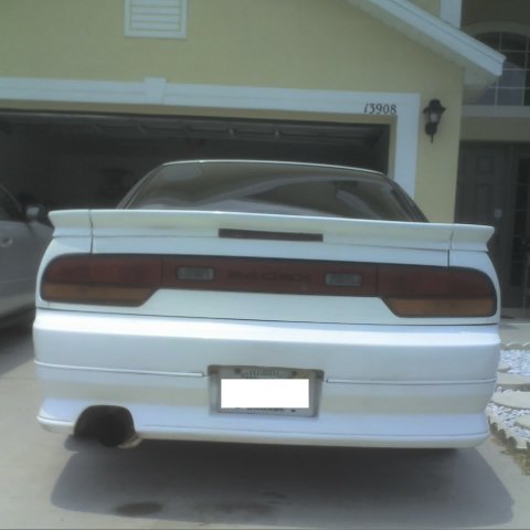

Let's see a before and after shot of what you will attempt to accomplish.
BEFORE:
AFTER:

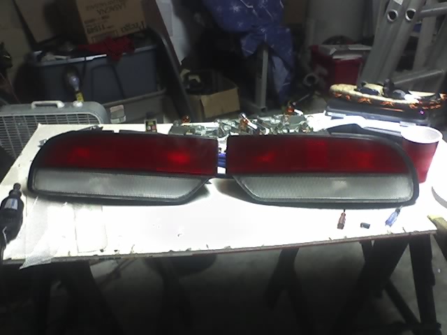

Here's an idea of my table area:
Don't mind the kool lube... I was uhhh... testing things out.

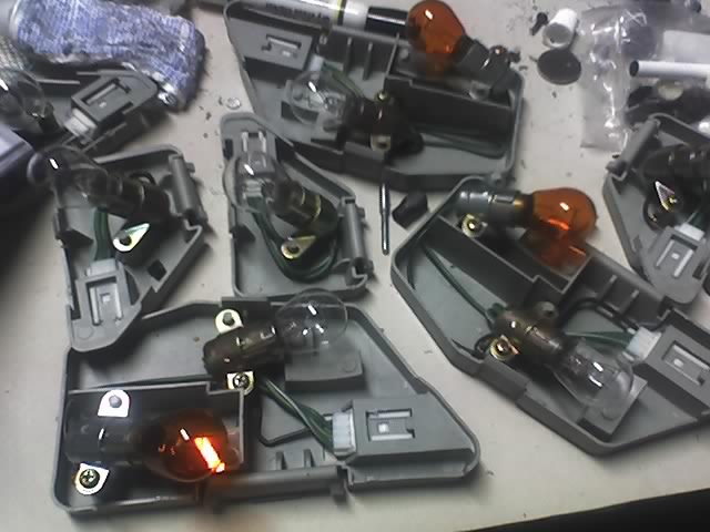

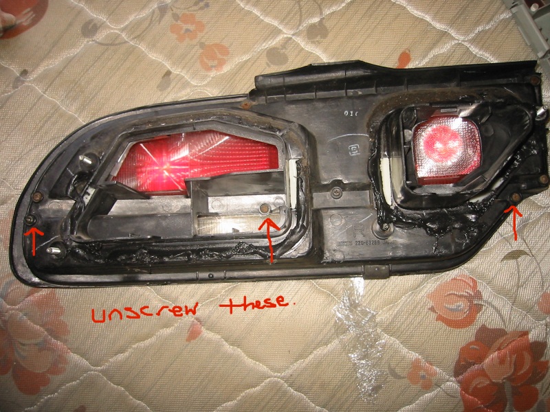

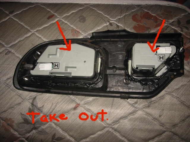

First things first. Go into your kitchen and warm the oven up to 275 F, and wait till it reaches this temperature. At this time you can begin taking out the bulb harness assembly out of the tail light (the back pieces that the bulbs rest in). Take those out completely, because if you put the tail light in with the electrical stuff attached, I don't know what could happen. The bulbs will more than likely shatter.
You then unscrew the screws holding the amber piece in place. You won't be needing these anymore.

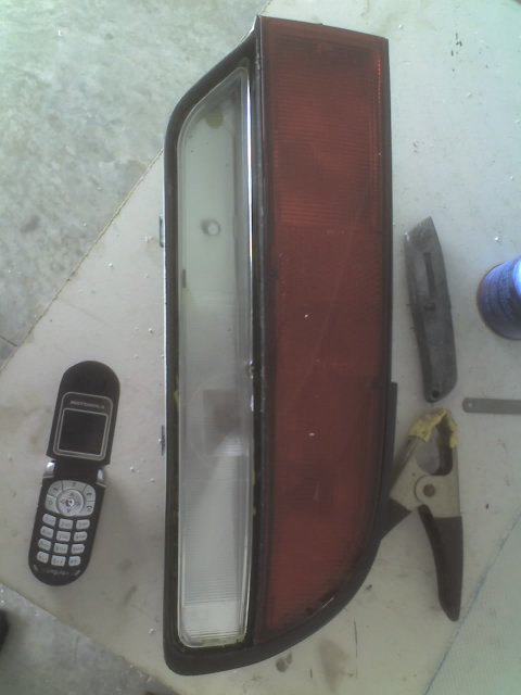

Once you've taken those out, wrap the entire tail light in aluminum foil. You don't have to be perfect, but try to cover most of it. Do one tail light at a time! Put it in for about 10 minutes. Once ten minutes is up, take it out, and then put the other one in. You then take the baked tail light to your work space and immediately begin to pry to amber piece out with the screw drivers. Now this part can get tricky and I suggest some type of eye protection because chips of amber pieces might decide to come flying up at you at random. If the glue doesn't seem melted enough for the amber section to come out with ease, then throw it back in the oven for another 5 minutes. If it's fighting with you then you didn't bake it long enough, trying to pry it out like this will leave you nightmares. I tore my hand in half practically trying to rip it out. Ouch.

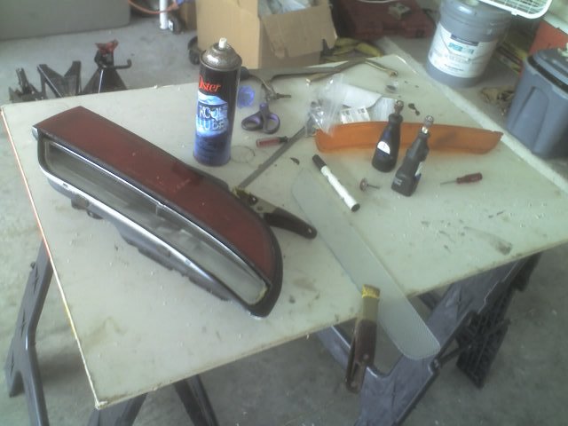

And here's the same picture twice to show the amber piece separated from the tail light...
Oh wow look, this is almost how we want it to look like in the end... almost...

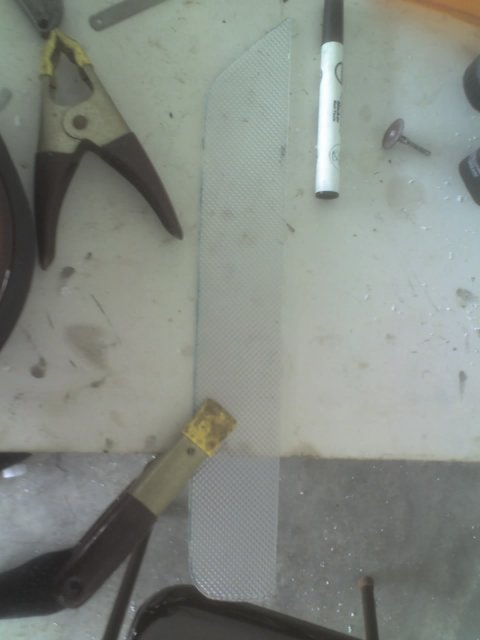

Take the amber piece and trace it to the best of your first grade abilities onto the prismatic pattern. Make sure you do it on the SMOOTH side and not the side with ridges otherwise good luck washing the marker out of the grooves lol.
IMPORTANT TIP: Give yourself plenty of slack in case you mess up on the tracing. It's better to trace bigger rather than smaller, either way you'll be trimming it down to a perfect shape with the dremel later. Don't cut corners here.
Now comes the dremeling part. The part you will hate I promise you. Honestly I can say it's almost not even worth the trouble but I'm a pretty determined person to get things done so I get my shit done. However at this point you can come up with your own way to cut this shape out. I used the dremel and the cutting piece along with the sanding piece. The main focal point of this procedure is just getting the basic shape out from the sheet of prismatic pattern so you can work on it better. Then trim it and shape it down to the perfect dimensions so that it fits right into the tail light.
Eventually you will get a shape like this:
You will use this as your UNIVERSAL PATTERN. Make sure it fits snug into the tail light. It has to fit tight, you need to use a little force to get it in, if it just goes in with no force it will not seal correctly when you use the silicone. You keep this that way you can duplicate it with ease whenever you want to make more tail lights.
So now that you have your universal pattern, trace a LEFT and RIGHT section for both tail lights. (SMOOTH SIDE FACES OUT) Don't get it confused or you'll shoot yourself later when you're halfway done cutting it out.
