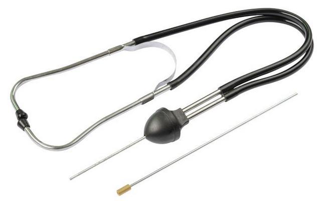

Old 07-20-2015, 07:17 PM   #9
burnsauto
burnsauto's Avatar
Location: 717, PA
Posts: 3,324
http://www.harborfreight.com/mechani...ope-69913.html
Done.

I'd get a stethoscope and at least look into it. Sometimes you can catch a little problem before it develops into a big one with a tool like that.
Thats a good point. I will try and pick one up. thanks
