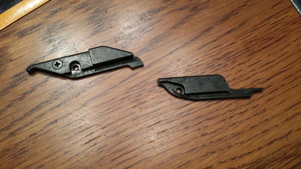

Anyone know what these parts are that broke off my sunroof? Off a 1995 nissan 240sx se model.

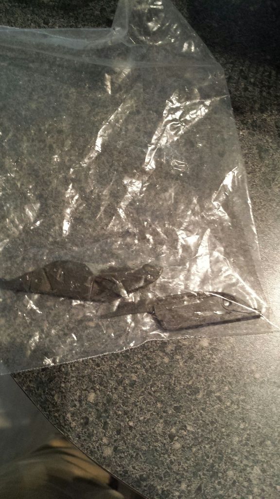

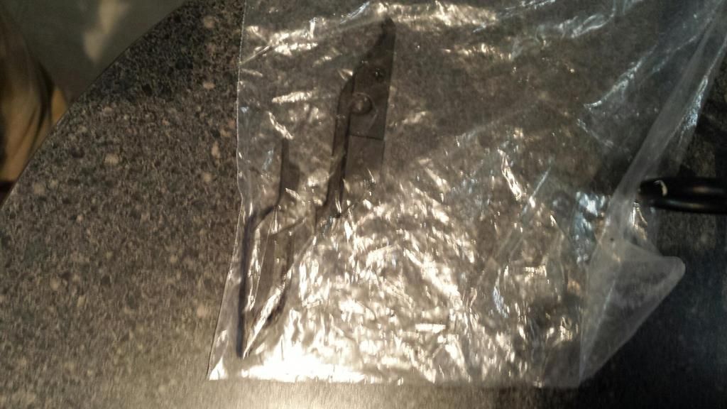

Would help if they were not in the bag.
Ill take them out just for you

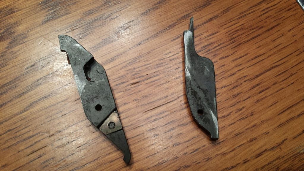

Those are the sunroof lid brackets that connect the shade to the sliding mechanism. They make sure the lid lowers and raises as it moves back and forth.
Part #:
Right - K1358-65F11
Left - K1359-65F11
They're pricey from the dealership. You'd have better luck finding a whole sunroof assembly from a part out.
