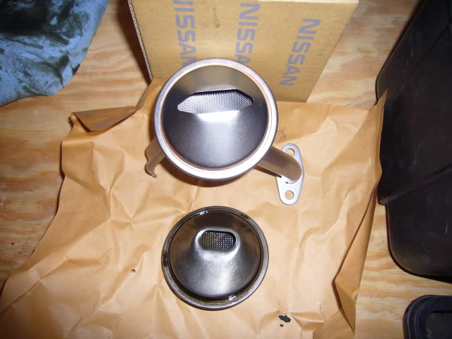

This trigger a 'member berry', when I was getting the car out of the old garage (long story short) a jack had slipped and hit the oil pan, denting it dead center. The dent goes in MAYBE 1/2 an inch and you can see where the oil strainer"kissed" the bottom of the pan.
I didn't think to much of it and ordered a new pan and inspected the strainer, which appeared undamaged.
Judging from this guide and the FSM the strainer wouldn't be something that could stop the rotating assembly? Or am I wrong?

Also, This is the strainer that is in the motor. The S14 style one (pictured top)

The strainer shouldn't interfere with rotating the motor over unless you royally botched the install.
Pull the tensioner to get some free play in the chain.
