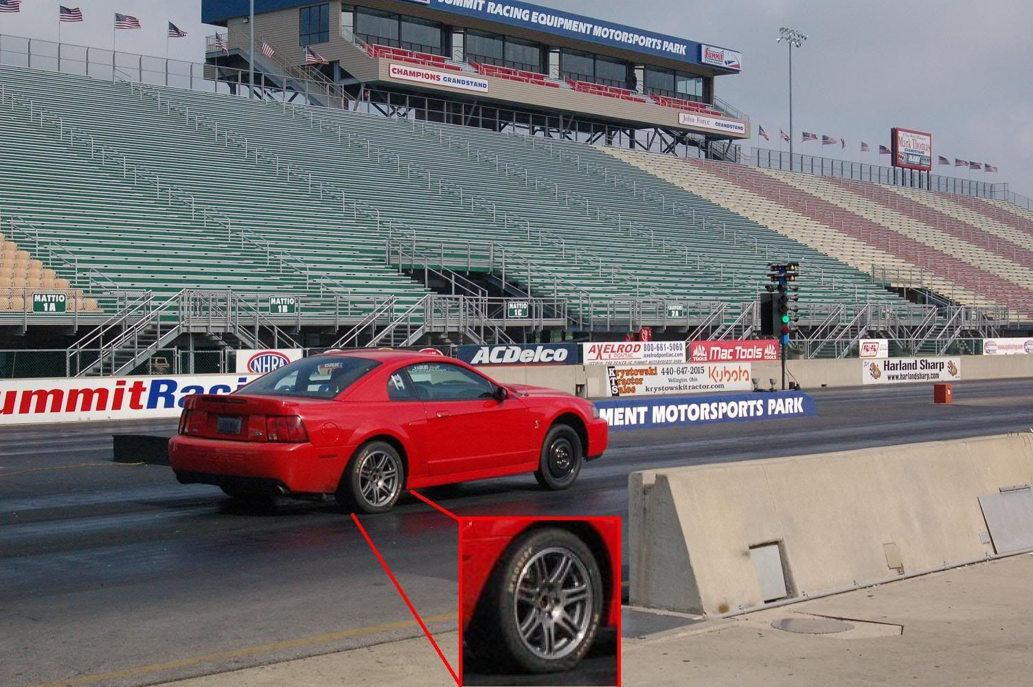

Originally Posted by LuckyX2 View Post
It was my understanding that you want some squat to transfer weight to the rear. This is incorrect? I understand what you're saying about energy being lost to the suspension but it is minimal, no? Once you get past the initial launch and compression of the rear suspension, you're not losing any more energy. At least that's how I see it.
If all the big power guys are running with minimal squat and it's working for them then I guess it must be right. That's on drag slicks though, I assume. Drag slicks have enough traction that you don't need to squat as much. It seems logical that you'd want more squat on street tires with less grip.
some yes but not like this
these guys have so much power they can do that LOL. but its lost motion plus a 28/10.5 helps lol
these here are Mustangs IRS on DR's
see the difference in suspension travel
MunkyW3rkz Racing

Oh well yeah, I didn't realize we were talking about wheelie levels of squat lol.
Obviously you don't want that. OP is under 300whp, has coilovers in the rear (which are presumably stiff) and squat reducing subframe spacers so I doubt there is a ton of squat going on.
It was my imagining that he was squatting very little and in that case could use a little more. I do agree that you don't want much more squat than those mustangs you posted tho.
