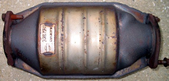

This a 96 so the cat is in the downpipe not in the S13 location. That's just a holow shell.

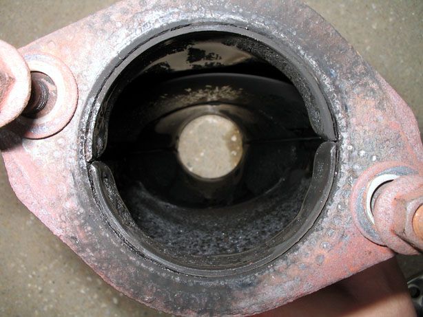

..well, i just unbolted it from my exhaust... i don't get emmisssion tested where i live so the cat is just sitting in my garage.
so, you took out the fake cat or the real cat?
This is a fake cat on the S14's

Since I got the right map sensor on my car I have not thrown it. It's been over 600miles. When I was throwing the map code the cat code would throw. they could have been related.
Originally Posted by mr_240sx
well where the cat used to be, i welded in a 3inch pipe so its pretty much a 3inch straight pipe!
was this a angled pipe. Cause the cat is in the DP and makes a 45 degree turn.
The DP with the cat is on the left. A test pipe in place of the fake cat is in the center and the cat back is on the right(black).
it looks something similar to that picture except for my downpipe connects to the new pipe completely straight and there are no bends in the pipe except for in the cat-back, which is a slight bend.

you do realize that what was in the place of the center pipe is Hollow?
