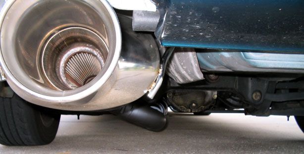

Originally Posted by S14DB
I went from an N1 to a Can and the sound went down.
[/IMG]
I don't see or understand how just a change in canisters can reduce db levels of the exhaust?
I've been in love with the sound of and have pleased with the gains of the HKS Hi-Power exhaust 60mm. But if I can gain more power while most importantly keeping the noise down just from a different design, then I will do it. My main concern here is that exhaust noise.
what's the difference in piping / resonator designs from the two exhausts you've had?
24Dee is offline   Reply With Quote
Mufflers work by sound pressure absobtion/dissapation. N1 cans are thin and can't absorb/manage alot of pressure. A larger can will absorb/manage alot more pressure. Also, the 80mm has 33% more surface area in the core to absorb more pressure, which makes the 80mm quieter than the 60mm. The reason people say the 80mm is louder is that the bigger can makes the tone lower than the 60mm and the ear perceives lower tones at the same dBL as louder than the higher tone.
loudness depends on lack of restriction.
muffler-sound suppressor. do is resonator.
2 types.
1) chamber (cherry glass pack, flowmaster etc) stock uses it, but to make one that actually is not as restictive is expensive. it restricts the gasses, slowing them down, thus making it quiter.
2) can type (n1 etc) its REFLECTION suppression, sound reflects thus getting delayed, thus being quiter but sound good (n1, my rsr, etc)
also u got resonators which is a REFLECTOR.
so its not only the size of piping its the availability of muffler and/or resonators. exhaust is about velocity on ka. you dont need backpressure, muffler does that job fully for you at 3 inches. anything bigger than 3 is too much
Ahhh I see says the blind man.
Good shit.
I was searching around for regular canister exhausts that I like and found the Blitz Realize and the ex-mag. I couldn't find any clips of the Realize but I found one of the ex-mag on an n/a KA and honestly, it sounds pretty close to the Hi-power 65mm exhaust that i've planned on buying. I like it. Might be too loud for some at higher RPMs but I really don't get on my car unless on the highway so I really don't care.
The only concern of mine so far is that i've read that overtime the ex-mag gets louder on a n/a engine. Any validity to this?
