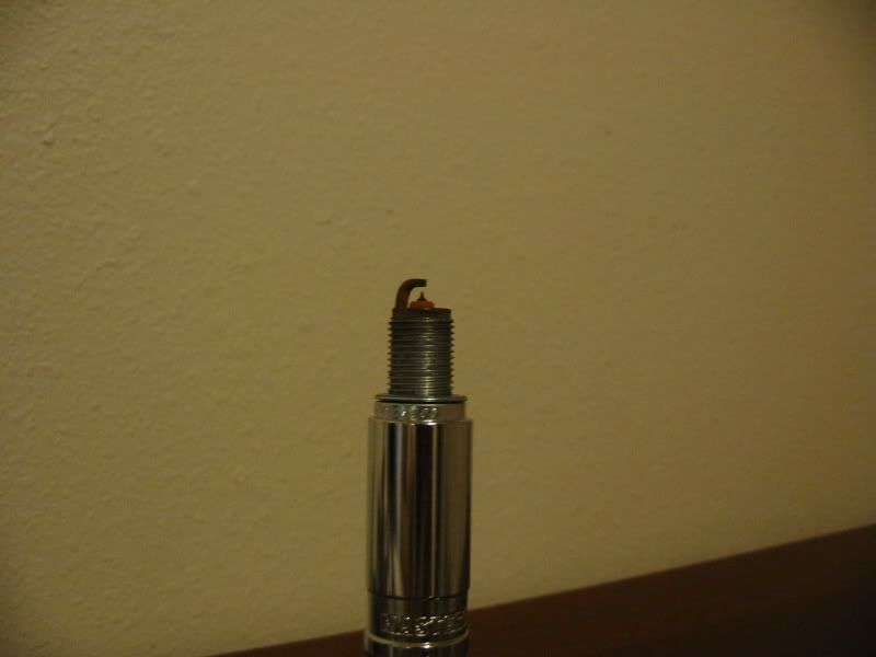

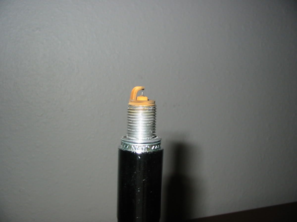

I just installed NGK Iridium IX spark plugs a week ago before the ButtonWillow track event. Well, I added an octane booster before hand, and I recently noticed a drop in gas mileage, especially on the ride back home (~230 miles).
I was curious about the mileage, since the only thing I changed since then was the gas (Chevron to Mobil), NGK wires and plugs. So I checked the plugs just now, and they're all orange. Does anyone know what this means? on this website at the bottom,
http://www.mopar.com/m_maint_inspection_plugs_tune.html
it indicates fuel additive or octane booster depsoits on it.
Did this permanently affect the performance of the plug and would this be the cause of my noticable drop in gas mileage (~19mpg highway w/ a/c). Does it affect overall spark?
If the condition of these plugs creates a non-optimal spark energy, then I will definately just replace them again. help?
Here are the pics, with and without flash:

This is an interesting post. I have note seen that plug color before. I don't know what it is, but I certainly wouldn't put it back in my car. I don't understand why people reuse spark plugs. If you take them out you might as well put in new ones regardless of condition. They only cost $40 max. If that improves your gas mileage, you'll save the money back in a few weeks.

It is fuel additive.
If you notice, the electrode is clean. The ignition system has more than enough voltage to burn clean the light dusting of what the additives leave behind. You shouldn't have to replace them unless there is some heavy build-up.

black bottle 104+ will leave the same deposits anything that is a 6point plus additive will "red" the plugs check your o2 it is probably gummed up with that shit too which is why your milage went to hell. THe plugs shoud be fine just look funny the o2 on the other hand can be damaged by that shit.

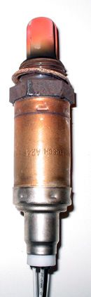

It's the octane booster. You can see what Seafoam in the gas tank did to my O2:
If the plug looks like that. I would bet the O2 does too. "Race" stuff usually can fubar an o2 so make sure it says o2 safe.

The NOS octane booster uses MMT. MMT is known to coat the O2 sensor and spark plugs with a orange color. High concentrations of MMT can damage the O2 sensor so take a look. Small amounts like in a octane booster should be fine.
Doesn't mean anything bad. It's normal, just a different color.
