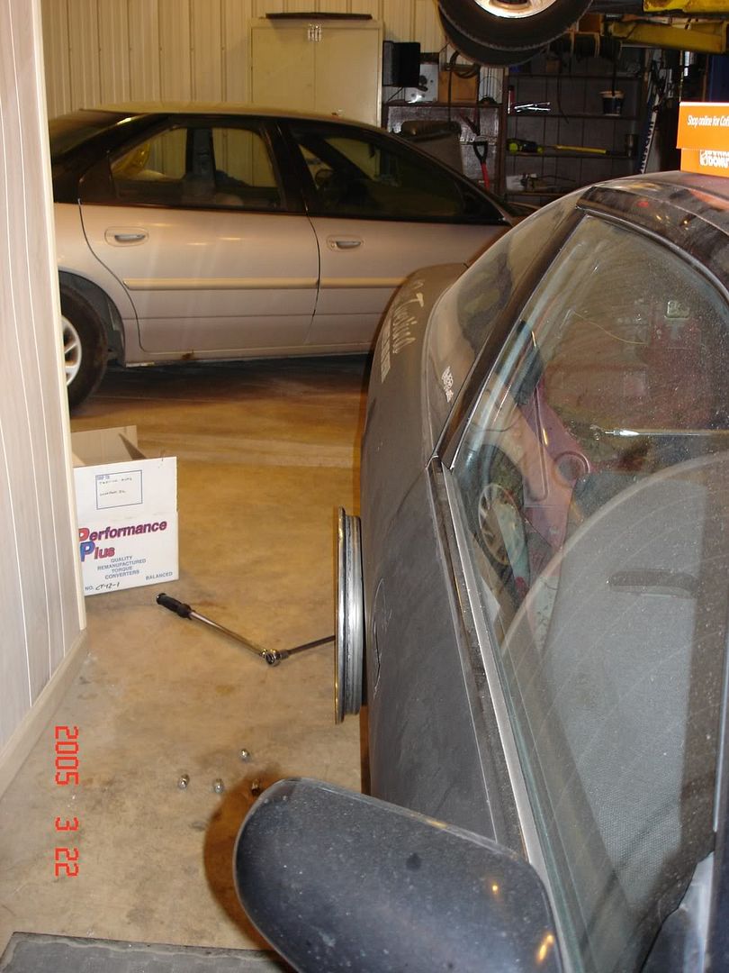

Fronts: 16x7 +18 spaced out to -9 THEY WONT CLEAR Z BRAKES!!!
Rears: 16x9 +/- 0 no spacer
Tires were 205/55/16 all around.
16x8 -10 is 3mm inset from 16x9's
NO PULL JUST A ROLL
They came in the foloowing sizes:
16x7 +18
16x8 +18
16x8 -10
16x9 0
I have a pair of each but the 16x8 +18
Ill get more pics later.

do any of the sizes clear Zbrakes? Specifically the 16x8 -18 and the 16x9 +/- 0

i would think the rear wouldn't be an issue.
but offset has nothing to do w/ wheel/brake clearance.
and that's +18, not -18.

it does because spacers can be used to alleviate any such clearance issues thus making the offset of the wheel important in relation to said spacing and in need of appropriate compensation.
