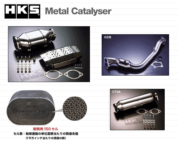

"These monoliths on average have 64 channel openings per cm2 this allows for high flow rate and high efficiency because of higher surface area."
The HKS seems to use 150cpsi. So that would show some improvement over stock style.

The NISMO Verudi eggplant Potts catalyser. They put the cells in an elliptical shape to increase flow across the cross-section instead of the turbulence that happens with a normal cell design. Increases flow by 20% and still meets Japanese emissions standards. Even with the VQ35.

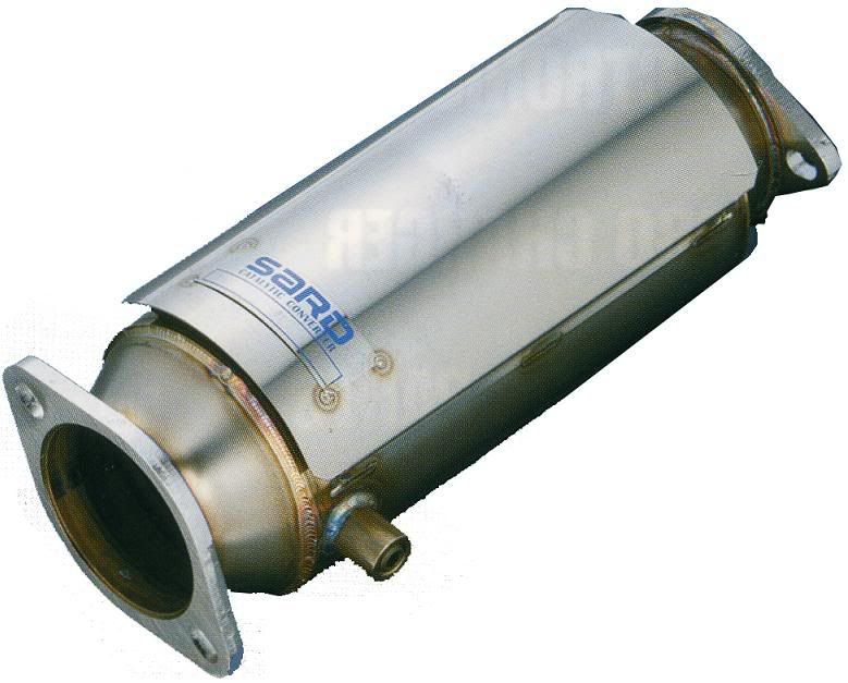

Ya I saw Sards version of this at a shop the other day. Cost is $750
I've seen it for $599. No specs yet...

I read good things about the HKS and Nismo catalyzers on a Hong Kong skyline message board. HK smog controls are fairly strict from what I hear so at least from an emission perspective they probably do their job. I just can't get over the price. The cheapest one i'e seen for 240's is the sard catalyzer, they go for $400 all day every day on yahoo japan.
