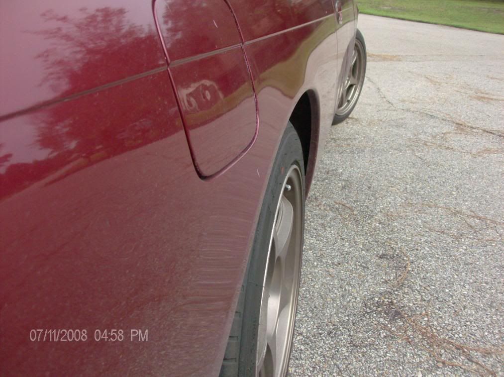

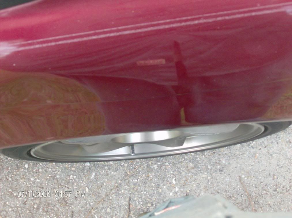

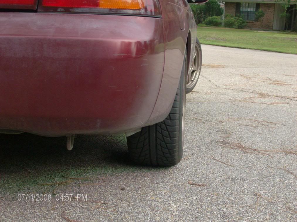

And I has pictures!
56k = Death.

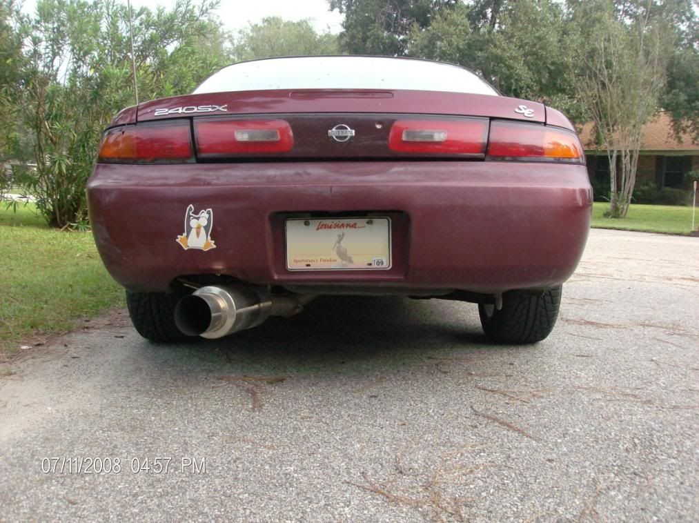

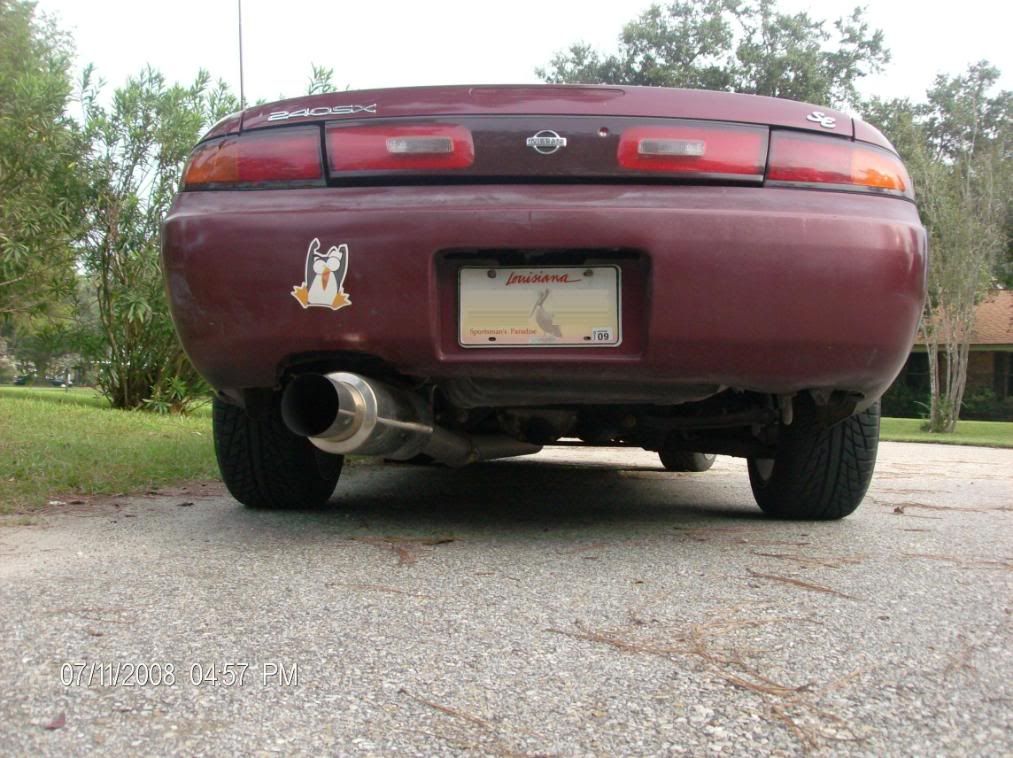

So here's how the rear of the car sits

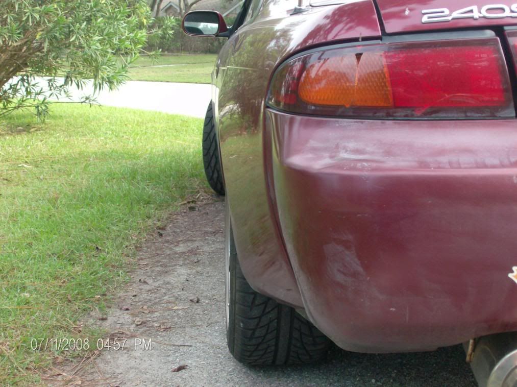

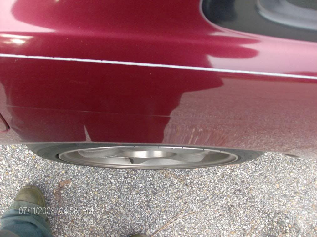

The passenger side's fender/tire relation
The driver side fender/tire relation. Notice it's outward flare.

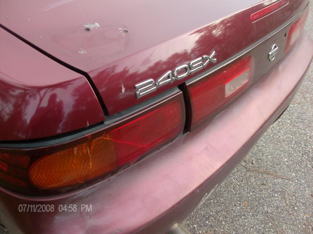

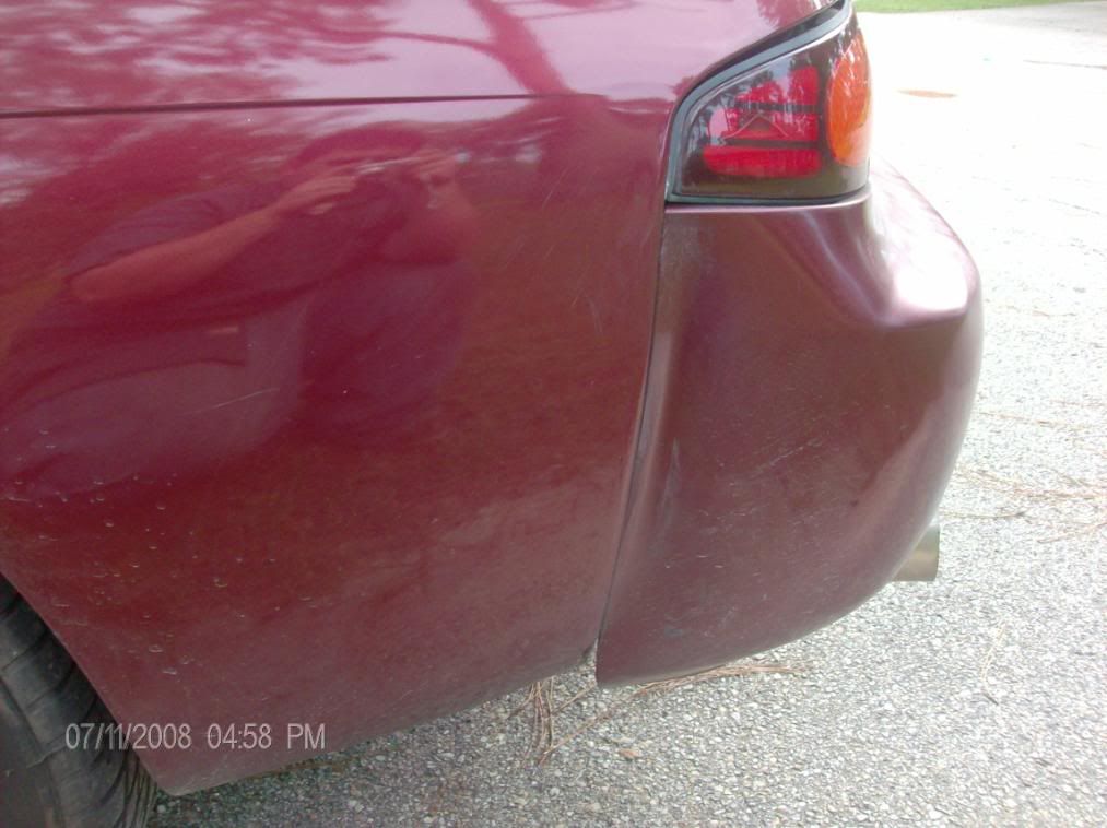

The dent in the quarter panel. The smaller dent further back was from a jackass with a Dodge truck smashing his door against my car. Fucktard.

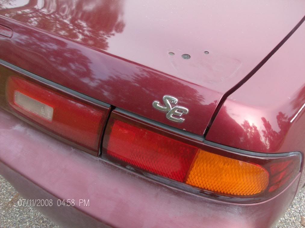

Closer up on the bumper's buckle. Really shows how far out of shape this part really is.

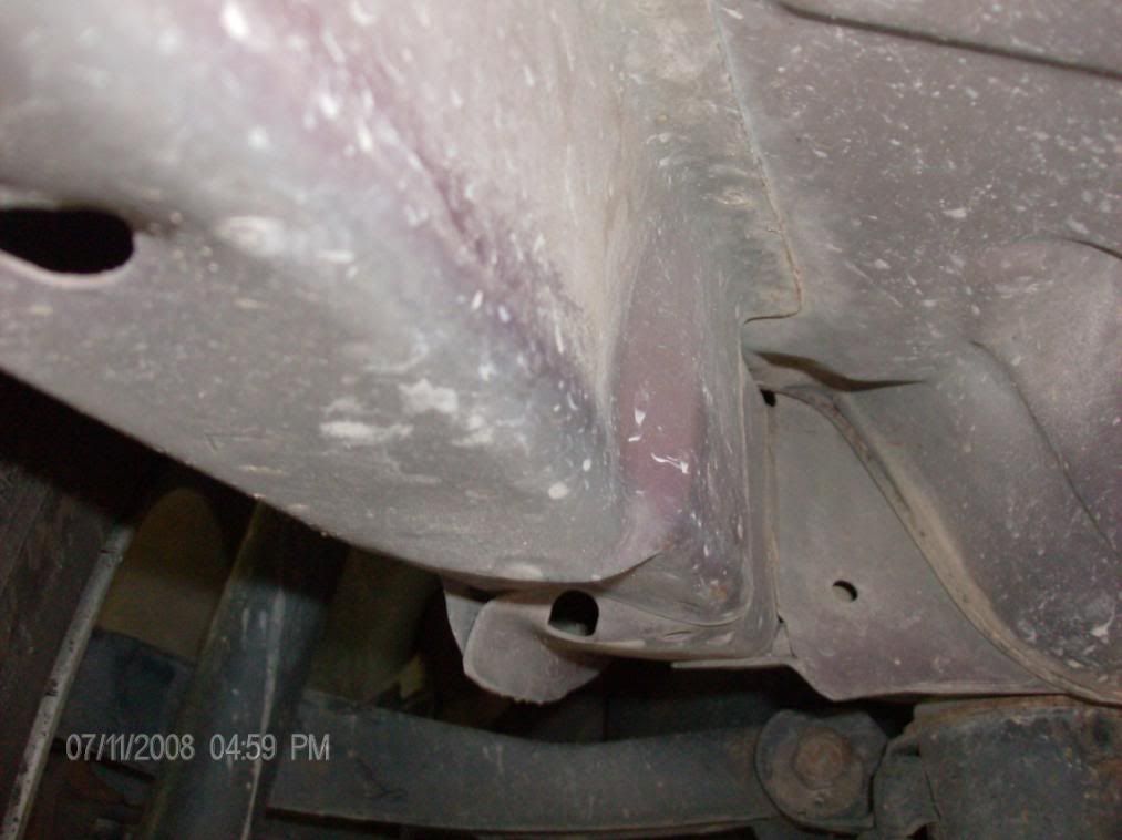

Nasty trunk gap

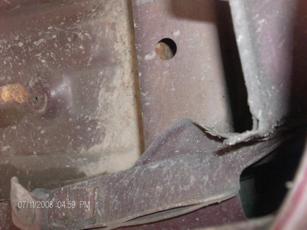

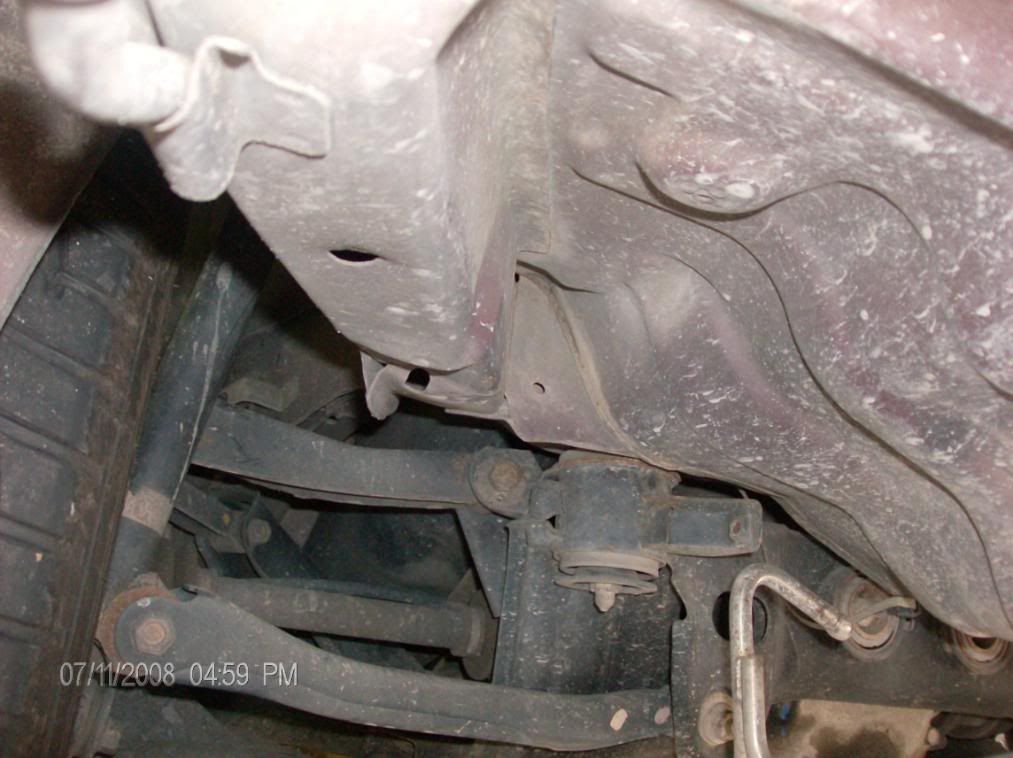

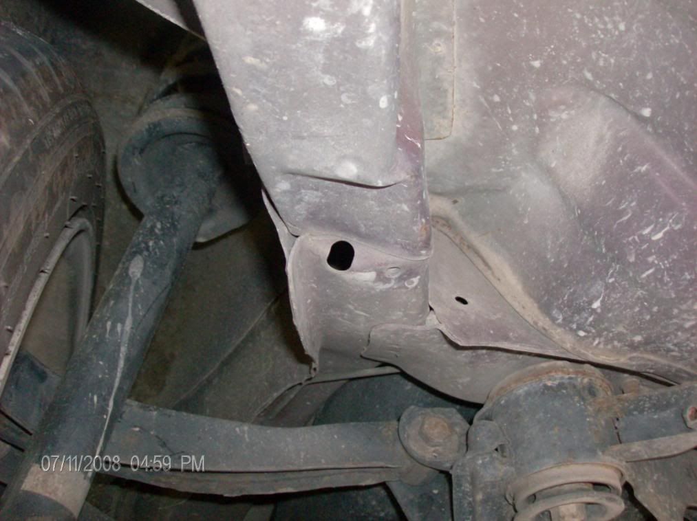

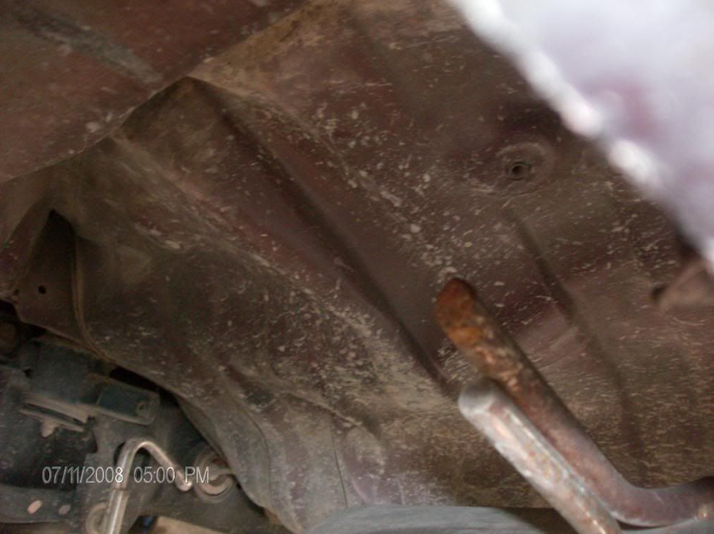

Now the nitty of the gritty: The fame damage, and sheet metal under trunk.
Whadayathink?

Frame puller would be the only way.

frame puller.
Its behind everything suspension wise, so you should be driving safe at least

thats a weakass hit, frame rack and a lil time and it will be better than new! If you have the car apart when you take it to a shop that will help cost. I think its around 80$ an hour (around here) for frame work. Plus parts if any are needed.

Sawzall + bumper = Damnit I need a new penguin sticker lol.
I gotta hunt down a bumper support and hack that thing off. After that, its off to get estimates.
I was told the car rolled backwards into a trailer... but it would have to be moving pretty good to do that shit, imho.

When i got my S13, i was told it rolled into a sign post in the front corner.
One day i pulled the bumper off to see if I would tweak things back in place, and the whole support fell of on the "hit" side.
One bolt sheared and the other ripped out of the frame.
rolled into a post,......sure.....

Yeah. Doesn't matter. I picked up the s14 on the cheap, a bumper support is $150, and a bumper is like $60. All I need are adhesive backed sanding discs, tape, paper, and primer and I'm good to start painting. I already have everything else.
Or maybe I should skip the bumper, and get a body kit while I'm painting. lol.
