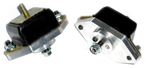

Or you can get real poly ones from JGS. I have Nismo ones and next time I'm going with a set of these. They don't raise the motor at all.
The mount is made by Energy Suspension and the billet adapter made by JGS
The motor is located just like stock (not higher like the Nismo MMs).
Price will be 119.99 a set (a little cheap than Ni$mo MM from most sources). Your choice of red or black. The only mod would be enlarging the MM engine bracket hole to 7/16", if anybody doesn't have a drill I can do a core exchange on pre-drilled engine brackets... but it is really easy to do since you will need to either pull the brackets or the cross member to get the engine mounts in anyhow

Originally Posted by KOUKI KA-T
I fuckin' give up. The L Nismo mount is identical to the R OEM mount for the KA and vice versa. I've done 3 s14 ka's, including my own, with my own hands. If you ignore the big friggin L and R on the side of the mounts and just put them in by comparing the actual mounts then you'd never know the difference.
Actuall this is untrue. At first, I thought the same as you did. I even installed it that way. Well when I took out the Right OEM mount, it had the same shiny bottom as the Right Nismo mount. They were the same. So I had to uninstall the mount. Now I gotta say the putting in the Right Nismo mount into the Left OEM mount side is a lot easier, but WRONG. No doubt, that they WILL fit either way, but I compared the mounts and the Badging matches up.
Here is a pic of the "shiny" Right side OEM/Nismo mount im talking about:
