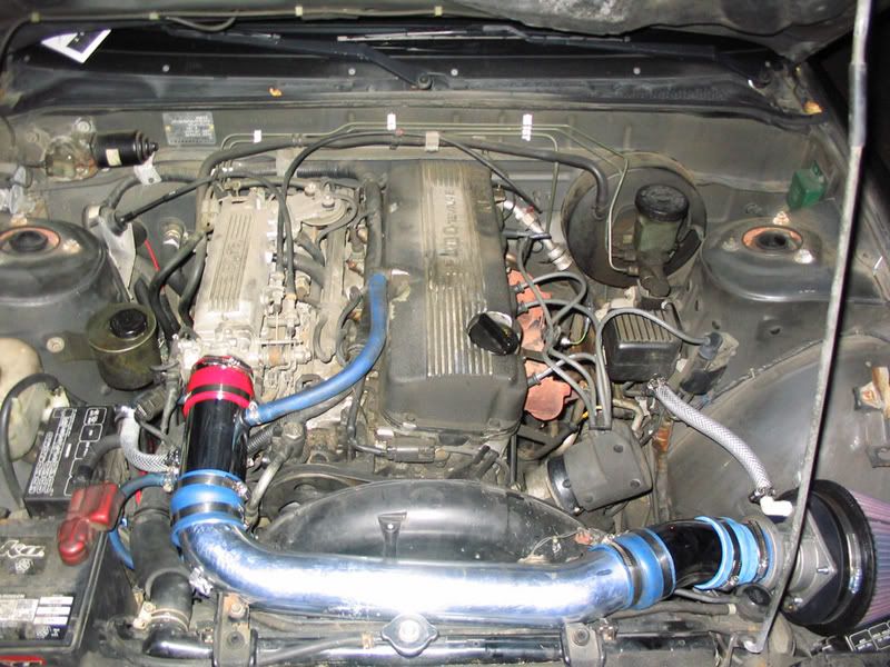

well heres the story, i got bored on sunday and installed taurus elcetric fan i had in my grage, not realizing the stock intake wouldnt fit any more. so here its 6pm on sunday and i needed a intake. so i head over to superautobacs and look around no intake for my car but they have this spector modular intake thing. i decide to give it a try. turned out perfect. ended up costing me about 100 bucks becuse of the AEM dry flow (50). i bought some extra pieces becuse i didnt know exactly what pieces i needed but all you really need is 2 section of pipe, a maf adaptor, hose adaptor kit and 3 3" sillicone couplers, here is the link http://www.spectreperformance.com/ part numbers are 8771 x3, 8711,81413, 8668, 8698, you will need a drill to drill out the holes to make the hoses fit and a foot of 5/8 heater hose for the crank breather, the pieces are plastic so its really easy to work with and it all clamps together

WOW bro. thanks. haha ive been trying to figure out the exact parts i need

they dont have anything to make one big bend like that the clamp is on the pipe when you get the set, i fixed the number its 8668 not 8998

hm. i might just go see if i can get a big piece from somewhere so i can use it later when ka-t.

how did you wire up the fan
did you run a switch or did you use the relays
