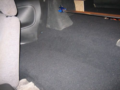

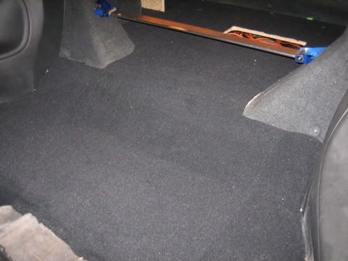

s13 Finished my custom S13 hatch interior
Well i have been working on it off and on for a week or two and finally just got the majority of it done. I decided i didn't want my subs or an amp anymore, i dont even have a deck for crying out loud. I weighed my amp, subs, deck, box and wiring and it weighed out to well over 100lbs.The back seat and seat belt stuff weighed out to around 40lbs. So i decided to go with this set up. Which with the material and carpeting only weighs in at about 30 lbs. It still needs a little finish work. Where the spare tire well is i decided to make a compartment out of it. I put gray ozite carpet in there and it now holds the following: jumper cables, cig. lighter air compressor, mag lite, can of fix a flat, small cheap ratchet/socket set, screwdrivers, adjustable wrench, pliers, and plenty of zip ties and it still has room for other stuff. The battery is also hidden away in the back passenger side corner. Tell me what you guys think.

As far as the materials go i used the thinnest piece of MDF i could find. Its the same material you build floowing and sub boxes with but a little thinner. For the carpeting i used black ozite from walmart. It was 10$ a roll and i only used about 1.5. For adhesive i didn't feel like busting out the gun and mixing some glue so i used a can of 3m Super 70? spray adhesive. The actual hatch part was the easiest. I used the factory carpet for a template. There is a carpeted piece that covers the storage area and when its on you cant even tell theres a storage area. Also i cut out a fuel pump access door but carpeted over it. This way if i ever run into a fuel pump issue all i have to do is take a razor blade and slice around it and voila. Where the factory seats are was all just using cardboard templates and many hours of fitting and fidgeting for the tightest fit. Also before i did anything i gutted the back and removed the sound deadening and primed and painted it gloss black. The whole set up weighs in at a little under 30lbs. Its lighter than the factory set up and IMO for a street driven car looks alot cleaner than a normal gutted 240. All and all it cost me about 50$ and is lighter than factory. It was the alternative for getting the origin lab CF template. If you have any questions PM me or post it up. Thanks for the feedback!
