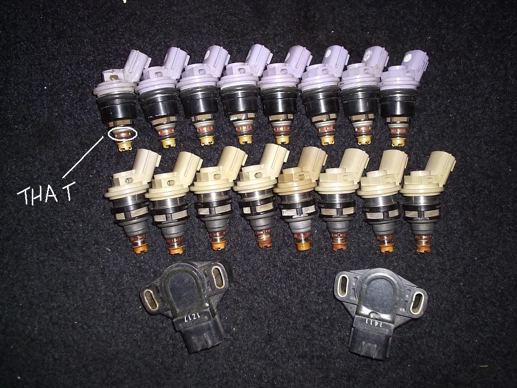

You need that buffer ring thingy (its hard plastic with some spaces cut into it), that part is what pushes the o-rings into seat, without them and or even with damaged ones (usually get damaged when someone re-uses old o-rings and forces then into place) they will leak big time.

Im talking about this part:

His have that little ring above the o-ring. But I'm talking about the big rubber thing that sits on top of the injector where the cap holds it in the fuel rail.

Yes, I'm pretty sure those push the injector far enough down to "engage" the o-rings in the rail.
