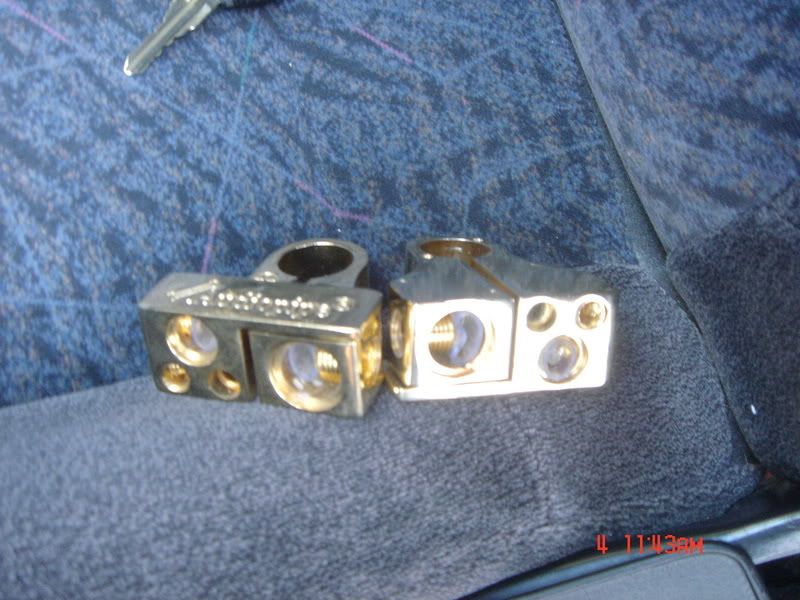

how to run wires to amplifier
hey guys i was wondering how you guys did this. i have a 4 gauge wire and it's nearly impossible for me to crimp a head on it so. i decided to get these and i was wondering what would i do with the "red head" that leads to the fuse box. would it have any adverse effect if i just cut the heads off and just run the wire directly into these audiopipe terminals? or does the fusebox require that i keep that red thing and what not. also, how did you guys run your wiring also to get no electrical noise, you went up to the intake manifold and then hard right once you hit the firewall to the exhaust manifold and drilled a hole in there? or did you guys just run the wire north of the battery and drilled a hole there? also, i'm planning on wiring up my amp under my passenger seat to keep stuff stealth. i'd like some input from you gurus before i cut up my shit and regret it.
thanks!

get proper crimps and add it to the glob of power connectors on positive. Home depot carries them and the good klein crimp tool. those red inputs are there for a reason, i think they call that the super multi junction port or some crazy name. Just dont run the audio output wires near other power wires and you should be good. I ran under my pass seat and just ran it through the center console.

oh, yeah also what kind of a head did you use to crimp the head too? b/c the head i want to crimp wont even fit inbetween the battery clamp cable. so there is no way it can get power even if i get it crimped that's why i got that audiopipe thing. maybe i'm not lookin' in the right place =D help please.
