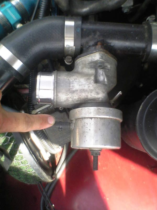

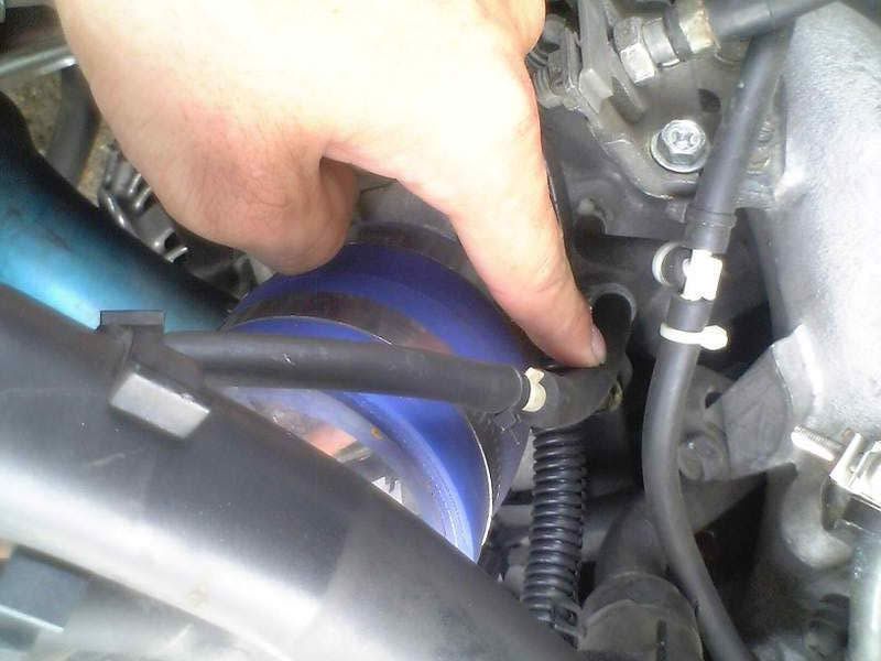

Run one line from here
(Leave the Back one unplugged)
Straight to here No other T's
Big nipple on top right of the Throttle Body
