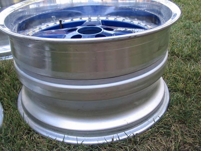

hey i have a set of work equips like in the pic below do u mount tires on this rim the regular way or is it reverse mount(rim upside down on tire change and clasp from the inside)???????????? never mount tires on the rims yet, first set?? please info!!!
this style wheel

is that the exact one u have?
if so it is reverse mount.
u see that drop center in the back? and the front is smooth all the way down
thats how u tell

mounts upside down but NOT clamped from inside out (unless you want teeth marks on your lip). upside down and clamped from outside. Any reputable tire shop will know how this is done. For extra protection, some shops use plastic or duct tape on the clamps.

ok so if the drop centers in the rear its a reverse mount, if its in the front its a regular mount.
this is the exact rim i have----

yep its reverse mount. gl and dont scratch ur lip. use the rubber/plastic thingys that cover the clamps

throw some rags on the clamps for a little added protection

Or go to a shop that grabs the wheel by the lug holes and center bore. We have a similar machine at work. It's a Corghi. Awesome machine.

All wheels with big lips happen to be reverse mounted
