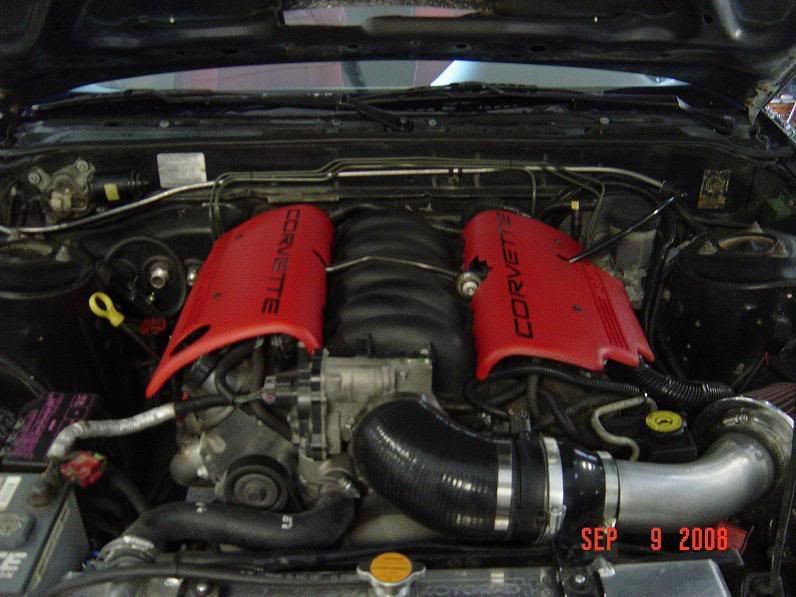

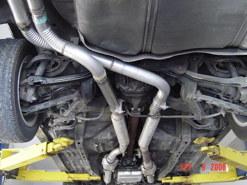

Here's my friends build in his 97 Kouki.
Import FanatiX Car Club
I will say, considering the LSx's weight compared to the KA's, its a good swap that won't adversly effect our car's handling.

Okay, for the quick end of it, I am going to say go with a LSx swap, whether it be LS1, LS2, LS3 or even super duper LS7. Either way, you're going to be gaining gas mileage (assuming you run a T56 six speed, 4l60e (automatic) mileage is a little worse cause of the gear ratio, and i can attest to that), ridiculous amounts of torque and overall power ON TAP, no waiting for spooling; and most of all, GM reliability. If you take your time and make sure everything is right the first time you hook it up, you should have zero problems and a turn key setup that runs the same all the time and won't leave you stranded.
A little more in-depth if you care:
As far as the weight dispute goes, the complete LS1 w/T56 tranny IS LIGHTER!!! than a stock KA w/ auto tranny. According to Hinson supercars, the stock 240 KA w/ auto tranny and all accessories comes out to be 596lbs; also according to Hinson, the stock LS1 w/T56 and all accessories weighs in at 470lbs. That is a clear 126lbs lighter! Now, say, just for sh*ts and giggles you go for a budget build and run a 5.3l or a 6.0l LSx based engine (iron block and aluminum heads, generaly out of a silverado, avalanche etc.), the iron block has a solid 80lbs on the all aluminum LS series. So add 80lbs to 470lbs = 550lbs, still 46lbs lighter than the stock KA. Now say you add a 4l60e automatic tranny instead of the T56; the 4l60e has 40lbs on the T56. Sooo, add 40lbs to 470lbs (assuming you run a LS1), you're at 510lbs, still lighter than the stock KA setup. But what if you run a 5.3l or 6.0l w/ a 4l60e, oh no, must be heavier right? Wrong. Take your 550lb 5.3l or 6.0l and add your extra 40lbs for the 4l60e tranny, where does that put you? That will put you at a solid 590lbs, which is indeed 6lbs lighter than the stock KA, but really, 6lbs? That's not going to make that big of a difference, so:
LS1 w/T56 = 470lbs---Pretty damn good weight savings
LS1 w/4l60e = 510lbs---Not too shabby
5.3l or 6.0l w/ T56 = 550lbs---Still not bad
5.3l or 6.0l w/ 4l60e = 590lbs---Not really a weight savings, but double the power of your stock KA makes it well worth it.
References:
YouTube - Hinson Supercars - LS1 240SX S14
GM Inside News Forum - Engine Guide (give it time to load)
GM Inside News Forum - Transmission Guide
As far as power goes, I could get into it, but for stock figures which I think is what you're looking for first off (then add mods down the road, excuse me if I'm wrong though) I'll just go the easy route and do this:
GM LS engine - Wikipedia, the free encyclopedia
Now for reliability.
According to Will Handzel's book, How to Build High Performance Chevy LS1/LS6 V-8's J.D. Power & Associates survey said that GM's LS based engines produced a rating of 9 problems per 100 engines manufactured. That means that only 9 engines out of every 100 made had some sort of defect or problem. To put that into perspective, Will's book also states that Ford's 5.4l V8 had a rating of 17 problems per 100 engines made.
Now having grown up in a shop, and having been taught by a GM employed mechanic, GM employed body man and ASE certified father that specializes in GM engines, and having my own LS based swap I can tell you that these engines ARE one of the most reliable and toughest engines ever. We have serviced in our own shop many many 5.3l's and a few LS6's. The biggest problem with the 5.3l's is that the stock fuel pumps go bad, but that is solved with these swaps anyway being that you will run a Walbro 255. Another simple problem we see that arises with these powerplants is simply clogged injectors, but this tends to be on shop/work trucks that get lots of abuse and no cleaning. Other than that, we have never had a LS based V8 come to our shop blown up, the closest we've had is a destroyed water pump. Another somewhat funny example has to do with my swap. It was late, probably around midnight and we had started the engine the day before, so we were just tying up random things here and there. We found a vacuum line that needed to be hooked up, found a line on the car that resembled a vacuum line, so we connected the two. Later we started the engine and it was running good then it started to stumble and idle poorly, we also noticed fluid coming out of the header. So instantly we thought that it was a cracked block, but I put two and two together. We were not sure where the car vacuum line came from, and this fluid seemed to be blue, not green like the antifreeze we put in. Turns out that what we thought was a vacuum line was actually the windshield washer fluid line! But the engine still held idle even after running through windshield washer fluid! Good for it, no, but it still ran through it.
References:
Amazon.com: How to Build High-Performance Chevy LS1/LS6 V-8s: Modifying and Tuning Gen III Engines for GM Cars & Pickups (S-A Design): Will Handzel: Books
To kind of sum it up, I am very very pleased with my swap. I did more of a budget build and got a 2003 5.3l and a 4l60e auto tranny. I did all the fab work with my father, including the headers, mounts, everything. With my mounting I was able to run a stock 2002 steel camaro driveshaft, no cutting or resizing needed, all I had to do was make a custom yoke for the rear diff. Since I got the car running and driving the first day, it has never once left me stranded, never not started, and never not been fun to drive. I have had two autocrosses with the car and I actually to my surprise really like the 4l60e auto tranny, drop in 2 and leave it. Where as everyone else has to go back and forth from 1st to 2nd throughout the course. Daily driving with the auto is where it's at. Mileage isn't too bad, but my torque converter clutch switch isn't engaging correctly so the tranny doesn't shift into overdrive properly, but that is the ONLY problem I have had with this swap.
If you have the money to go LS2, DO IT!!!! You will not be one bit dissappointed and you can't beat the stock N/A power and reliability.
If you or anyone else has any questions about an LS based swap, please feel free to ask me as I have two giant files/folders of pictures from my swap, and a whole folder in "My Favorites" dedicated to LS swap info.
I hope this information helps you and others, and sorry for offending someone or wasting bandwidth or whatever if someone thinks I'm a noob or a stupid swapper ruining S-chassis vehicles.
-MunsonAuto
(P.S. Here's an exhaust clip and some pics for your motivation!) http://s266.photobucket.com/albums/i...newexhaust.flv
I personally would rather not have the hood scoop, but due to running the 5.3l avalanche DBW (drive by wire) throttle body I had to because at the time we didn't feel we could make the mounts any lower. But the LS2 DBW throttle body is a different style and sits lower, thus not needing this "redneck mod" haha.
www.tannermunsondrifting.com
