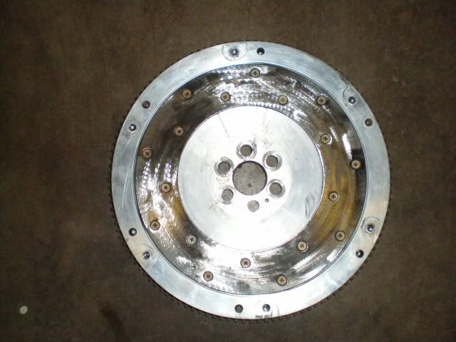

It's an n/a KA haha.
I also have an opportunity to buy this Fidanza aluminum flywheel for 140$. Apparently it only has a couple miles on it, but those couple miles were put on during 10 dyno pulls.
Not sure if it's a good deal or not.

looks fine to me, your original pp and flywheel looked fried, and it seams the issue you were having is very similar to clutch chatter yours was just 10 times worse

slider2828 is close to perfectionslider2828 is close to perfectionslider2828 is close to perfectionslider2828 is close to perfectionslider2828 is close to perfectionslider2828 is close to perfectionslider2828 is close to perfectionslider2828 is close to perfectionslider2828 is close to perfectionslider2828 is close to perfectionslider2828 is close to perfection
Lol.... Fidanza buy it, and change the face of it which you can get from fidanza.....

to the OP. did your car make a loud winding noise too whenever it jerked forward cuz thats what mines doing too and i couldnt find anyone with a similar problem.

it really sounds like it was the brackets you took off. was your engine revving while it slowed down? did it the rpm spike or drop? if your pp wasnt makin full contact ur rpm would spike. i was going to say i had a problem with my throtle position sensor that made my car car lose power and go like there was no problem kinda like that. but clutch pics and mounts not being on most likely caused it.
