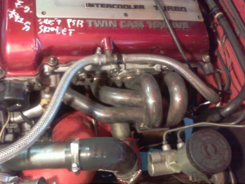

the rod that the dip stick sits in is really lose. i can pull it up and down but it doesnt come out. how do i tighen that up?

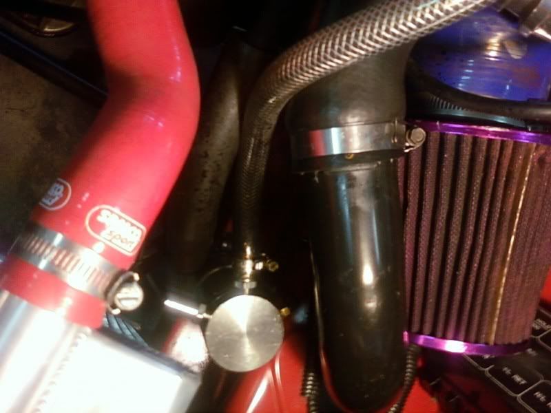

also i think my catch can is routed wrong. i have the side that is facing the front going to the catch can and the other nipple to the catch can goes to nothing. where should i have it going to? i dont have a spot on my intake to connect it to due to the fact that it is not the stock pipe. what should i do with the open side?

take pics of your catch can i'll show you the proper way to do it

if anyone knows the thread and pitch on the bolt for the rod that the dip stick goes to that would be great too. i cant find a bolt that will thread into the head for the dip stick.
i dont have a spot on my intake to route the other side of the catch can too.

you do no "need" to hook up the catch can to your intake. you can put a breather filter on it. but you could gain a few hp by hooking it up
the dipstick rod - its just pressed into the block. just tap it in

ok notes well taken. thanks. i believe it is pushed in all the way and just comes up easy. ill give it a tap with the ole hammer and see if that puts it in further.

you need a long screwdriver.. put it on one edge, tap lightly, repeat on the other side... dont just wack the top of it you will break something
