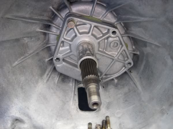

i think he snapped the shaft pictured above where the bearing is placed..thats just me, we"ll find out soon enough, keep us posted

alright.
finally got it off.
what a struggle.
literally another half inch on the sides of the tunnel would make it soooo much easier. Had to lower the engine via the subframe bolts(or whatever they are called, lowered whole suspension)
The pivot ball looks good.
the seal looks good (thanks johnny.)
the tranny was full, as the pavement can verify. (couldnt wrestle the trans, move the jack, and keep the catch under it, so it made a mess.)
The clutch disc/plate had slid down to the bottom of the area its supposed to be pressed in. could have been the struggle with the tranny,
but...
Had 3 finger loose bolts out of the 6 on the pressure plate. They were every other.
So I took them off by hand.
Started to take the others off, and decided i should see if they were loose, yup.
Got about 3 turns on each going tighter, so they had also backed off a bunch.
So i took them off and the pressure plate and clutch.
They look fine to me. but im gonna post pics.
So i guess the gamble is,
was it the pressure plate backing off about 3 turns worth, that wouldn't let it engage?
or is there another issue.
BTW, the tranny drain and fill will not budge.
but when it was on, i took the rear sensor out, and it started leaking slowly out that, and its about the same height as the fill plug, just opposite side. (so i can refil there i am assuming??)

hey crimson rocket
yeah idk my buddy was either drunk or just didnt give a shit
but yeah what kinda wear do u think it would do on my car?
or what would it affect the master tech at nissan (where i pulled the tranny out)
told me that it should be ok cuz it only wore out the little ring looking thing im guessing that the pilot converter or something that only the auto trans has
what do u think it might have messed with just so i know before i put everything up

Originally Posted by CrimsonRockett View Post
What. The. Fuck.
There's no way you could put a manual transmission on with a torque converter still in place.
If you guys didn't swap out the auto pilot bearing, that'll cause excessive wear.
Castro, the backed out bolts were more than likely the issue. Those things need to be torqued down to like 110ft lbs. I punched a jack stand at full force when the socket came off the flywheel bolt. lol. Screw those things.
adjustable impact+locktite hahah save your knuckles!
uperformance is offline   Reply With Quote

loctite and torque them to 22ft/lbs. look in the fsm for the spec but from what i remember its 22ft/lbs
Thats what I am thinking.
Just wanted to hear it from another source, lol.
I am gonna talk to Jon(forget his online name), in just a sec, when i borrow the pilot alighnment thing.
I dont have a torque, as i am also doing this on the side of a street, lol.
On the positive side, imma hammer the two spots on the firewall that were not letting the tranny down.
I will know if it worked in a few hours, and will post.
If it doesnt, then its prolly the tranny, but at least i will be able to move it before street cleaning in the morning, lol. (and they can wash up all that tranny fluid, lol.

put a jack under ur crank pulley with a piece of wood, and jack the front of the engine up, you shouldnt have to bash ur firewall/tunnel! sr is even harder than ka, but ka is easy!
flywheel bolts, i have never seen one get over tourqued, and ive seen some stupid people with impacts. the pressure plate is good if you match the tourque anyhwere over 30ft/lbs . tighten them all even, and snug thats how we get our trannies on without a clutch tool, you use the tranny as one, pull it back off, and tighten everything 3/4-1 turn of ur ratchet, they should all be tight,
cool. thanks
yeah, last time i pulled the tranny a couple years ago it wasnt so tough, but i had a hand.
I have the wood under the pully and the front subframe lowered about a half inch or whatever i could get with keeping all the threads grabbing.
I will tap the tunnel back just a tough to give me the little extra i need since i am there. (beat the outer firewall back 3 inches the other day to fit rims and tires, so i dont mind hammering it.

FIXED
All in and working.
Putting it in solo is a bitch.
my shoulders hurt so much, lol
works great.
still need to bleed the master a little more from when i tried that.
kitty litter on the street, and the cars back behind the gate.
Thanks for the fast help guys.
