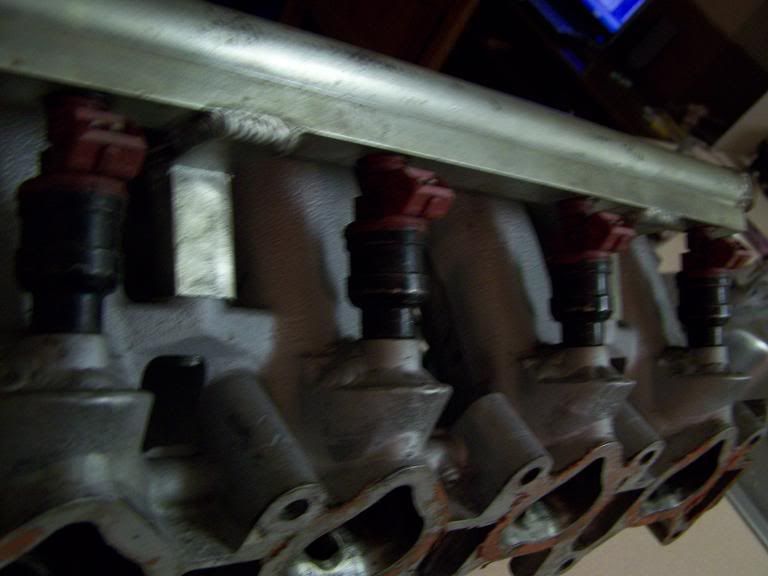

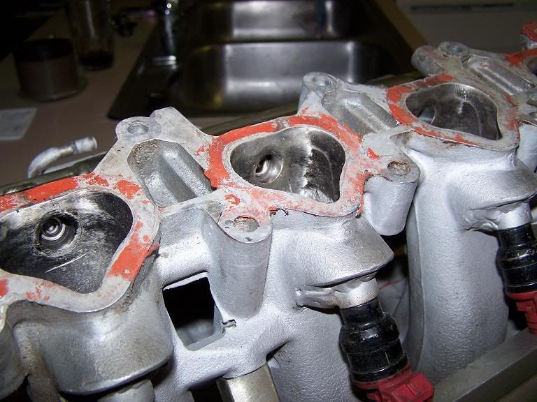

I had a KAT with 8 injectors.... 1000cc and 600cc (and 1000 + 300 at one point) and we did the same thing (primary and high boost settings). We were using an electromotive TEC3 to control it. the only issue that we ever ran into was killign spark plugs because of the angle in which the secondary set were positioned... it looked like this.
Could support 800HP @80% duty
Could support 900HP @90% duty
Primary was 450-650whp, secondary was 650-850whp
the injectors ran in sync (all 8 all-time), in sequence (4 on low rpm, 8 on high rpm), in stages (4 on low boost setting, 4 on high boost setting), or single stage (whichever 4 are chosen). The idea behind it was for more fuel and better bottom end with superior top end fuel support. the majority of the time it ran it with 18 lbs of boost making 570whp.
I would not recommend it simply because we were replacing plugs frequently.
Had a high score on cool factor, high score on perfomance factor, and a low score on maintenence factor.

Breitling > I think you would have had the same or better performance with only 1 set of 1600cc. Most ECUs are made to open injectors sequentially under small /medium load, then all at the same time at higher load. The CA18 ECU does that. And when it switches to batch opening, it opens the injectors twice per cycle to get a better spray.
