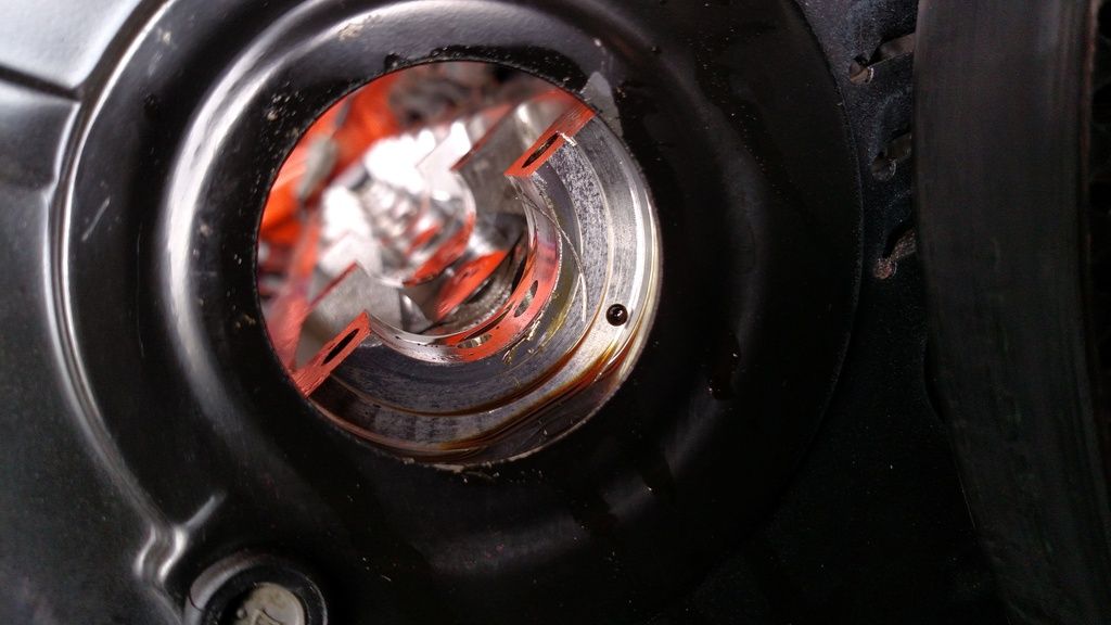

After I saw that, I decided to rotate the motor by hand. I noticed the intake cam gear wobbling a little bit and noticed it was a little cockeyed. I took the oil cap off and looked down while rotating by hand and noticed the cam itself wasn't rotating.

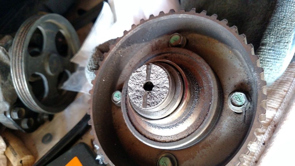

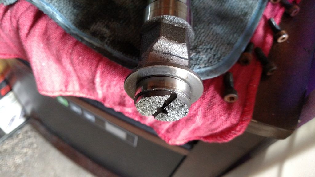

I grabbed the cam gear and moved it around and it fell right off. It snapped right in the middle of the first cam journal. Split the VCT oil galley right in the middle. The first thing I thought of was maybe an oil feed issue being that RB's do have oiling issues.

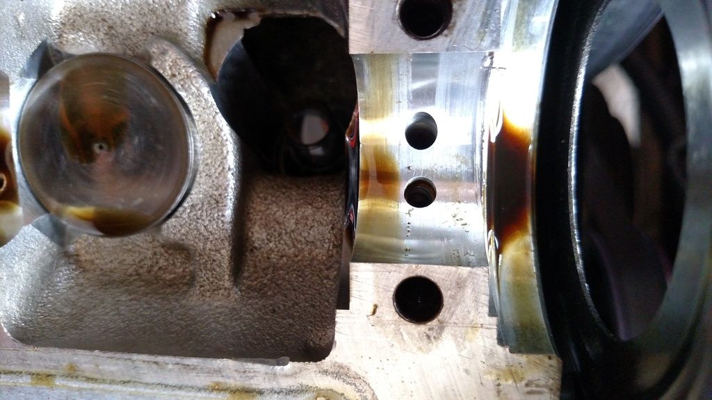

Fast forward to the next day...I took the valve cover off and the pulled the cam caps off to take the cam off. First thing I looked for was any sort of noticeable signs of oil starvation or anything else that would have caused it...nothing. There was so blueing or yellowing of the cam journal, the cam, nothing. The cam cap had a little bit of scoring, I'm assuming from when it actually snapped and rotated all fucky.

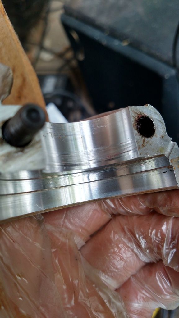

Prior to this happening, another random thing happened. While driving down the street, cruising, not doing anything stupid (although I wish I was so I had a cooler story to tell), and I hear this loud ass rapping noise. I pulled over and heard the noise under the exhaust side valve cover. I pulled the cover off on the side of the road and saw the rear most exhaust cam cap sitting in the middle of the 6th and 7th cam journals on top of the cam. The cam cap bolts had snapped clean off in the head, out of completely nowhere. So, instead of sourcing another cap, getting everything line honed, and all that jazz, I just got a loaded head from a buddy and got machined, cleaned up, etc.

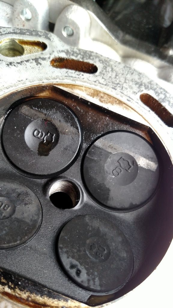

This head has about 500 miles on it. It wasn't something that happened right off start up. It actually made it 2.5 hours each way down to Staggered the day before this happening, without any issues. I have the head off at the machine shop getting the 2 bent valves replaced so I can put it back together. I just wanted to post this up to see if there was anything that maybe Ricky and I missed, and address whatever said issue could be before throwing it back together. Here's a couple photos. What do you guys think?
