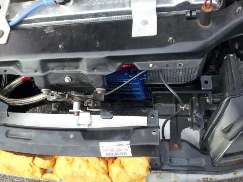

I know I need the S15 upper bumper retainer to fix this problem (part #62290-85F00)
But before I spend the money on it I want to know if it will work with my vertex front bumper. It has the opening in between the lights like this.
If someone has dealt with this problem or maybe has that bumper retainer & can give me some measurements to find out myself it would be very much appreciated! Thanks guys.

The part you show a picture of is needed. You can. UT it easily for West Covina nissan, unless the stopped selling g it, but when i did this, they had made you s15 items.

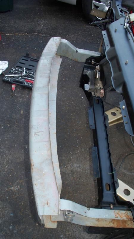

The part I did not see mentioned and a part I brought back with me from Okinawa is the part that you mount the bumper retainer to, which also supports the headlights. It is the actual s15 metal bumper. Where you can find it, not sure state side, but I am sure you can. I think I have a photo that may show it well.
Using both the solid bumper and bumper retainer align and support the bumper very well. The retainer helps enormously with the look and sagging as well as keeping the shape when working on it.

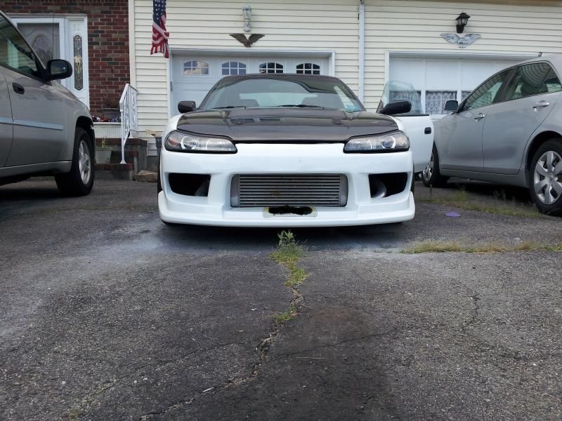

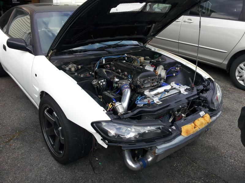

I had a s15 charge speed bumper and I used great stuff expansion foam to make a small foam guild around the metal bumper. You have to cut and adjust the mountings a tad for the ones that slide over the bolts on the free rails but that's it.
The metal bumper also cleared my greedy intercooler no problem also.

from my experience the bumper retainer alone will not fix the sagging problems. i did the retainer without the rebar and there was still noticeable sag and vibration. in the end i scrapped the retainer and built a very good fitting bash bar that supported the bumper and a couple extra tabs off the bar to the headlight brackets. i'm sure quickdiversion's solution works also but it looks like shit with the bumper off b/c of the foam and the factory s15 rebar basically provides no side protection.
oh and also the bumpers with the opening between the headlights will show the retainer.

Ok now I have to show more pictures to defend her honor. Even though I sold her.
I am pretty sure my way will work for you as it is all stock support structure. It may not be the best as previously pointed out. But this way not a drift car.

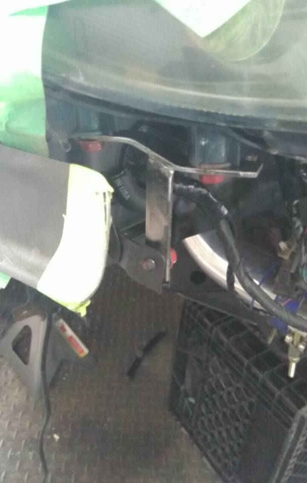

If you're worried about headlights bouncing and wobbling i made these for the outside of the lights. they sit on the S13 stock mounts located on the outer most edge of the core support and connect to the two bolts on the outside of the lights. Simple and easy to do if you have some scrap metal laying around.
They are strong too, i can grab the whole headlight and try to move them and they don't budge. Other than those mounts i am using the plastic supports that rest on top of the rad support and the standard s15 mounts as seen in the second pic (borrowed from this thread with a circle for reference) that connect to a custom support i made.
Edit; the light's do not bounce on the road, and i am not running that retainer. Just FYI
They were finished and painted after this photo, but it is the only one i have at the moment
