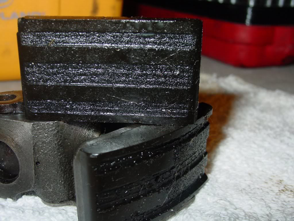

Also, on most KA24DE engines just removing the top guide isn't sufficient to stop the timing chain noise. You'll also have to remove the driver's side guide....
The top guide sits directly behind & between the cam gears. Look closely and you'll see the two bolt holes removing it leaves behind. The 2nd guide you can remove is the one on the driver's side (right), just below the exhaust cam sprocket.
The two bolt holes on the left side of the pic are for the tensioner, which you leave alone. I was doing a whole timing chain replacement when taking those pictures.
And here's what your stock (top) guides look like, the ruts are carved by the chain as it makes that noise.

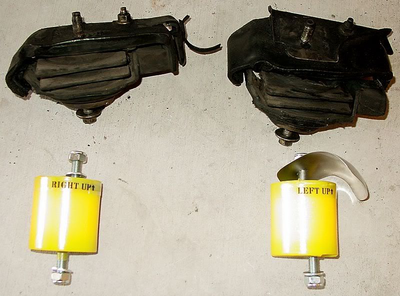

Here are the stock mounts compared to some great upgrade pieces offered by "drift freq" on here. He also sells them along with the Nismo tranny mount.
