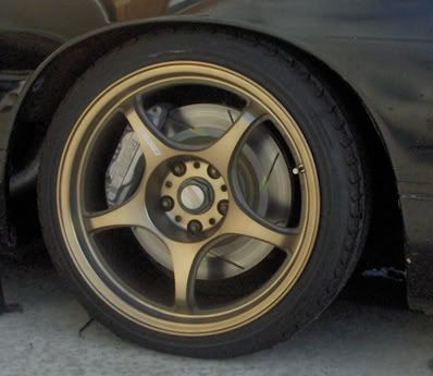

I have SPL kit. It's awesome. Gonna get Z33 Brembo calipers soon ,cause the Z32 caliper are made for 11" rotors and dont contact all of the Z33 rotors,
but a great up-up grade from stock

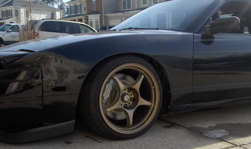

I've got the spl kit on my S14 as well
Just the overall feeling over the standard z32 brake upgrade is worth buying. I love it.
Fits perfectly behind my Z33 17" wheels

upSLIDEdown is close to perfectionupSLIDEdown is close to perfectionupSLIDEdown is close to perfectionupSLIDEdown is close to perfectionupSLIDEdown is close to perfectionupSLIDEdown is close to perfectionupSLIDEdown is close to perfectionupSLIDEdown is close to perfectionupSLIDEdown is close to perfectionupSLIDEdown is close to perfectionupSLIDEdown is close to perfection
Stopping power isn't really an issue, I mean the car stops like a Porsche now. As far as bias, I don't have any issues with it. I mainly want the Z33 Track rotors up front to fill up my 18" wheels. They will also provide less fade once I start tracking regularly, although I don't know that I'll even be able to get the Z32's to fade at all...
upSLIDEdown is offline   Reply With Quote

Ricks15 has much to be proud ofRicks15 has much to be proud ofRicks15 has much to be proud ofRicks15 has much to be proud ofRicks15 has much to be proud ofRicks15 has much to be proud ofRicks15 has much to be proud ofRicks15 has much to be proud ofRicks15 has much to be proud ofRicks15 has much to be proud ofRicks15 has much to be proud of
Need someone to clear up some confusion here, I can use Z32 calipers on a 4lug 240, but does that mean I can still use 240 4 lug rotors or do I have to modify 300zx brake rotors with a drill to have 4 lug??? rotors are the question and also pads, without a doubt 300zx pads?
Ricks15 is offline   Reply With Quote

Yep, you need to redrill rotors to 4 lug.
I have an availability question myself: does anyone have a a cheap source of blank 350Z track rotors? If I use this setup I'd rather use cheaper blanks that I don't have to worry about if they get cracked or otherwise messed up at the track. I can't find any rotors listed at autozone, napa, rock-auto, etc. however. Cheapest is powerslot at 230 a pair; ouch!

Have a machine shop redrill the rotors for you, don't do it yourself. machine shops have the tools to make sure the holes are aligned properly.
