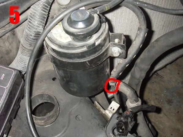

what do you guys do w/o this black canister
i was wondering for the people who remove the black canister...
what do you do w/ hard lines that go to it? cap it? or reroute it?

Remove the hardline all the way to the lower passenger side frame rail, but leave it open. Capping it will cause excess pressure in the tank and blow the fuel cap off.
+1
The black canister is your charcoal evaporative canister. It collect fumes from the gas tank and routes it to the throttle to burn off. It's an emissions device.
I suggest if yours is working properly, leave it the way it is. It'll eliminate some raw gas fumes from coming out.
If you want to take it off, follow the vacuum lines to the throttle and cap those off. Take the hose your circled and point it down so debris doesn't enter the hose. The best way would be to put a breather filter on it.
If you're anal, you can follow the line back to the firewall, or even follow the hard line back to the tank and reroute the vent hose to behind the rear bumper.

It's not too bad. I put my nose up to it and it doesn't smell that much, but probably safer to route it away from hot stuff.

im runing an SR right now i dont really care about emissions... i guess ill follow the line all the way to the tank and try pointing it somewhere else... thanks guys....
would it be safe to leave it uncaped or anything pointing down under the car aroudn the frame rails?

Definitely. You may not pass the visual if they don't see the EVAP canister. Won't affect your tailpipe sniff test though.
When you go to the tank, there's a one-way check valve in the line to stop fluid from coming out the line. You may want to keep this.
I would stick a breather filter on it and not have to worry about how you mount it.

I sure as hell wouldn't do it. The OE setup is designed to pull the fuel vapors out and compress them through the canister's filter, breaking down the pollution. Once the car is shut off it's vented into the frame rail (the lower outlet that snaps into the rail). Hooked straight to the intake you'd not only be pressurizing the tank under boost but you're also pulling in the excess fumes from the tank during vacuum, effectively adding fuel and running the car rich.
