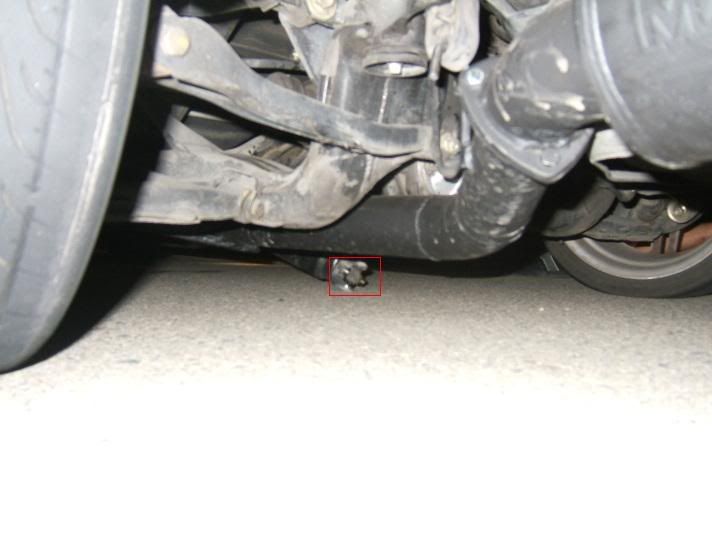

there is a disk or round peice that is suppose to be there. it's the round peice that bolts the shaft to the differential. can anyone help me out I lost it on the freeway and I need one to buy one. Whats that peice called?

pic isn't so good, but... if what broke used to be physically part of the driveshaft...
i don't think our driveshaft components are replaceable like that. you probably need a new rear section driveshaft.
other alternative is to get a one piece driveshaft and enjoy the humming

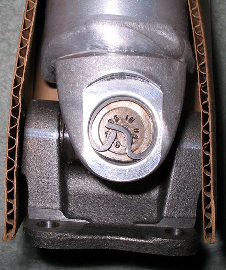

you broke the U-joint flange. Cause I can see the U joint hanging there on the end of the driveshaft. I don't want to know what kind of crazy launches or shift locks you were doing to break that. I Suggest a driveshaft from a junkyard or go to a 4x4 shop and have them make you one with Spicer u joints like this one.
The part on the bottom.

He didn't break #1 he broke the part of the driveshaft that bolts up to #1 and the U joint. That's why it's hanging there. Would be hard as fuck to break a input flange.

I havent launched this car yet. and I bought it lowered. I rarely drive this car and when I drove it it finally snapped. Anyone know where I can get this peice? if you fine me this peice I am willing to pay you $50 bucks shipped. I am in the military and at this stupid school so I don't have time to look for it. also I am away from my car. my car is back home in cali and I am in on the east coast right now for the next few months. if you guys can help me I would gladly pay you $50 or a reasonable amount. by the way, if I buy an aluminum driveshaft shop will it come with the flange? that was my plan buy on driveshaftshop.com it doesnt even show the part I need on the driveshaft. am i shit out of luck here? by the way, when ever I go to the Fresno junkyards, theres rarely any 240's I'm lucky to see one thats already stripped. as of right now I am having a local shop repair my driveshaft. all i need to do is provide the lost flange. Help would be greatly appreciated.
THanks.
ROss
p.s. 4x4 shop can provide me with the flange?
