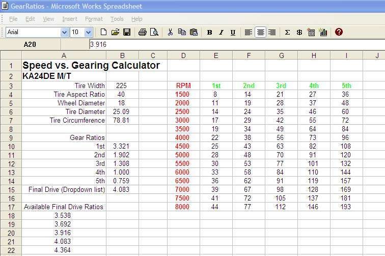

Try my gear ratio calculator spreadsheet.

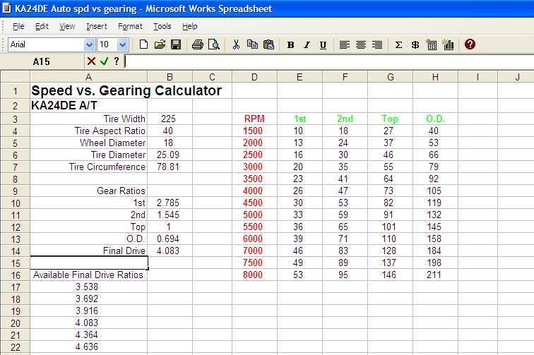

Is there a way I could figure which gear ratio I have if I know my car gets I believe 79mph @ 3000rpm my car is automatic with a JDM 180SX VLSD and my wheel and tire size are:
18" wheels with 225/40/18
From that info could one find out what final gear ratio I have even though I got an auto tranny?
P.S. I dont have Excel just the viwer but I do have Microsoft Works Suite 2006 and I was able to open it with Microsoft Works Spreadsheet and I can make changes and it does the recalculating automatically to .......

I figured it out, pretty cool shit:
KA24DE A/T
KA24DE M/T
