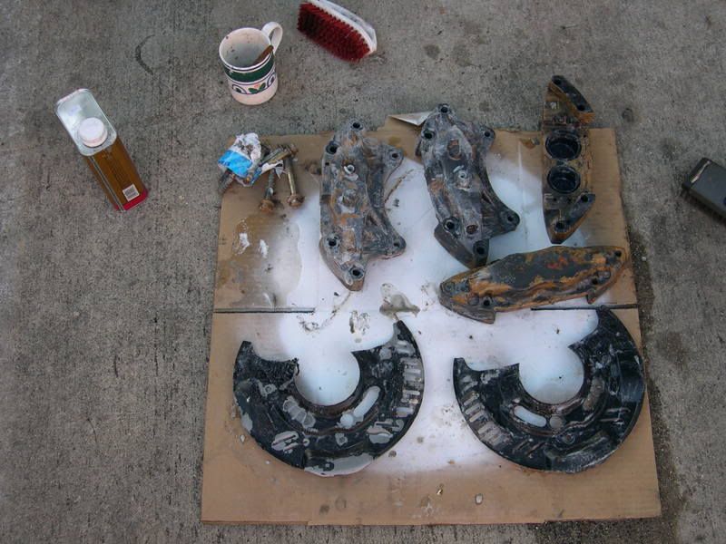

STEP 1: If you have not yet removed calipers from the car remove them, I cleaned mine prior to starting. You will need to disconnect the brake lines and unbolt them from the hub. Also remove the pads, to remove the pads there are 2 pull pin clips thru a set of long pins. The pins hold the pad and metal bracket in place. Remove the 2 pull pins and slide out the 2 longer pins and everything will fall out. Keep in mind there are small plates on the back sides of the brake pads where the pistons hit the pad, these can be easily lost and are marked with arrows for direction.
STEP 2: You then need to split the calipers apart, to do this I used a impact wrench but if you have some good strength it is possible to break the bolts. Pretty sure the Bolts on the front are a 13mm and the rears use a allen wrench style bolt which i believe is a size 6. NOTE: I could be wrong about sizes on these

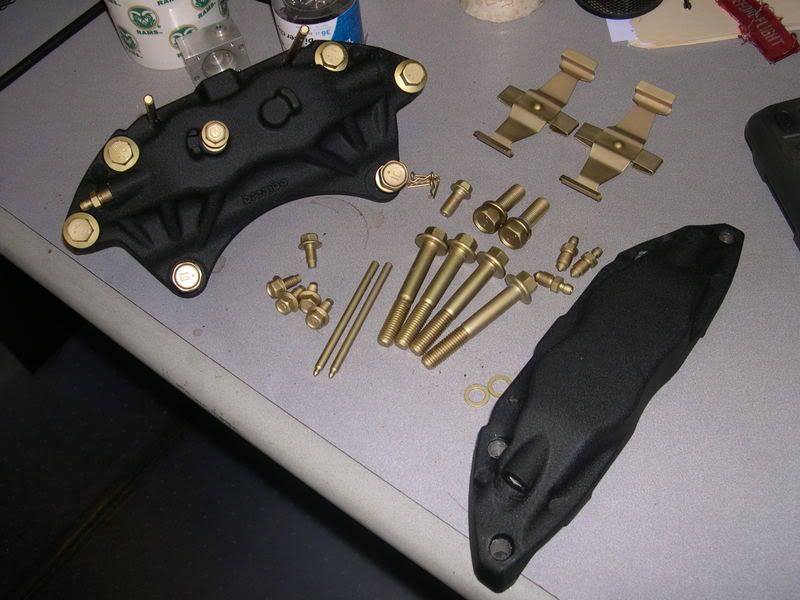

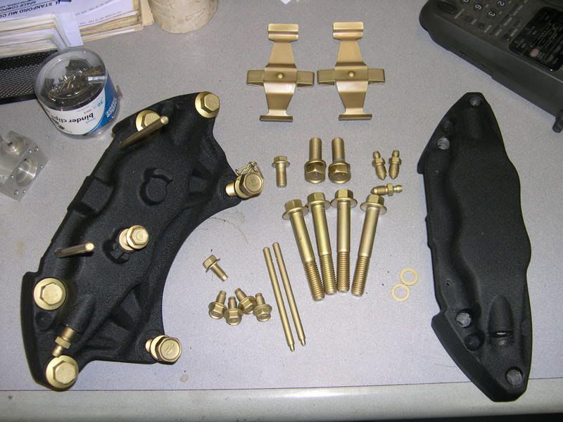

STEP 7: Send out your calipers for powder coating!

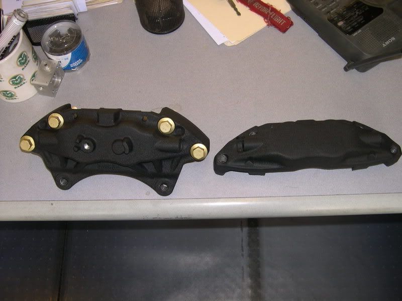

And the caliper paint code if you want to get a paint shop to make you rattle can spray paint its - 2001 Honda civic = Aerosol Spray Paint, 2001 Honda Civic: Inca Prl Y61P
if you want to go a different route.
and 3rd option - nicely done
