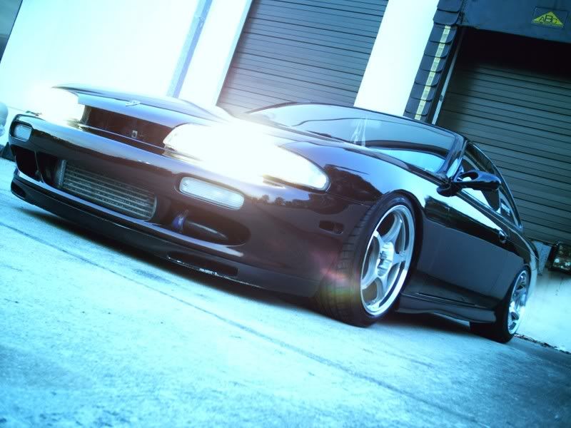

I don't think it will hit the shocks. If your looking for 265's I would get the 17x10+25 or +12 with 265/35
Heres a picture with 17x9+15 and 17x10+25 or +12 not sure.

wow looks like it sits nice an close to the fenders, i must be careful because i can not run any crazy camber or anything, granted im running 450whp its still my every day car to work and back.
Any idea whos car that is?

His user name is Team Rootbeer. You might have to roll fenders and I would run like 1.5 degrees of camber in the front and 1 or 1.5 degrees in the back if you don't want alot of camber. Theres more pics of his car in the LOW DOWN thread with different wheels. I think the wheels he has on the car now are 17x9+0 all around.

haha thats my car up there^

Looks damm good to!

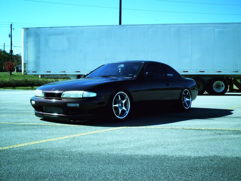

This looks RAD.

^^I think thats when he fully polished them.

here is a s14.5 with 17x8 +35 front, and 17x9 +35 rear.
honestly these wheels fit better on my s13, i would have put 17x9+20's on the front and 17x10's rear.
