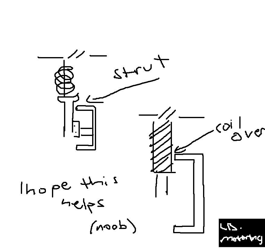

if they are clearing barely on struts,
YOU HAVE A PROBLEM.

haha, that's awesome!
basically what I was trying to explain but with a visual!

Not true, if you would have looked at the lovely diagram a few posts up...it shows that the stock strut suspension allows more clearance because the strut housing is the only part that the tire can make contact with. With a coilover, the whole assembly is shorter, so now the spring (which has a bigger total diameter) is the part to make contact with the tire
Thank You
Thank You
quoted for truth.
