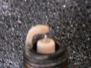

Im almost positive its the pump now that I look at the plugs. I checked the gaps to make sure they were all relativly close to .040, and the coloring shows lean/hot... I think.

Yeah after looking at the plug, Im leaning towards the pump myself. I wont be able to go grab another one till tommorrow.

ok i dont know why nobody has told you yet, but those plugs are done. fried. way too hot/lean. you need new plugs after you figure out why its so lean.

hah good point, I hope you didn't put those back in.

I just talked to another freind whos sort of a local guru who told me tanish color plugs are fairly normal for an N/A car. He mentioned high EGT's due to cruising, and the the stock ECU running pretty lean.
