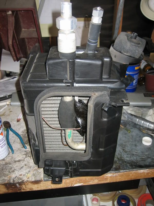

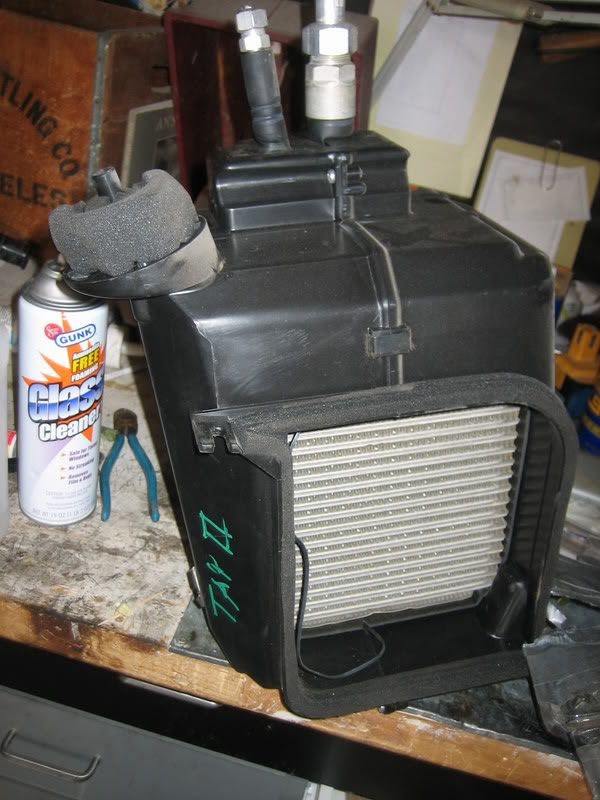

here is a pick
gotta240 is offline   Reply With Quote
Old 02-17-2007, 12:22 PM   #7
g6civcx
g6civcx's Avatar
Join Date: Apr 2004
Location: Virginia, USA
Posts: 5,764
Dear God, that's an AC evaporator inside the cooling unit. The two metal fittings are for your AC lines.
The heater core is located on the box to the left of that.
