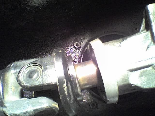

ok, i have this worry. i have this gap between the shaft and tranny. the shaft is hooked up to the diff, center mount and into the tranny. just wondering, should i worry bout this gap? by the way this is a jdm sr20det shaft. is there a lenght difference between a usdm ka shaft and jdm sr shaft?

That looks like it should be fine. Just watch it for a bit.
