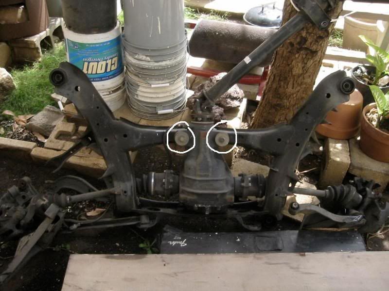

finally want to toss out the welded diff in my car i left it in my car for about 2 months now, it seems like it tearing my rear end apart as if it loosened everything, everytime i make a turn it sounds as if my cars body was flexing or something with the suspension... so i decided im going to put the old one back in , i was gonna do it the other day and notice the 2 diffs were different? are there suppose to be washers or something on the front mount of the diff? if so where what is it that i have to buy to remount my old diff? heres a pic i found, the white circled parts is where idk what goes beneath those bolts and if they are even regular bolts

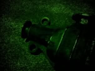

and heres the pic of my diff imma throw in, are there suppose to be inserts in those 2 big holes???

If its an s14 then its supposede to have the big holes,
The busings, go with the bolts that you bolt it to the dubframe with

yep my stock s14 diff had the bushings for the 2 front bolts, s13 vlsd has no bushings up there, smallers mounting holes, it bolts right up though, no big deal

do u know what those bushings are called and where i can buy them from?

I just re-used the ones from my car, they were in ok shape.

Diff bushings maybe? There's a thought. Your car already has a set unless it's an S13.
