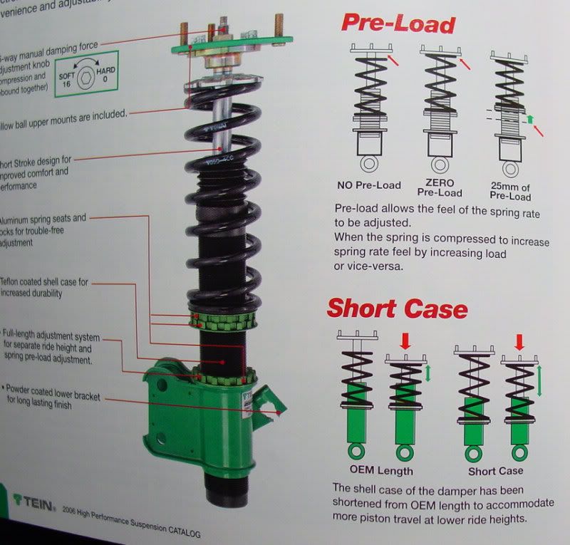

if by swooshing sound you mean the shocks mvoing, its ok to hear noises, they are suppose to be some noises when your going over bumps on the road
maybe you just not used to how stiff coil overs are, adding pre-load you should not bottom out your shock
this may help un-confuse yourself:
so if you think your bottoming out, then maybe that shop lowered your car by running no preload, meaning your lowered by dropping the springs instead of the lower brakets

Preload is not used to LOWER your car. It raises your car, and lengthens compression travel.
Just make sure that you aren't running a non captive(sagging) spring. The spring should be held in place and not allowed to move vertically when the wheels are off the ground. Use the lower mounts to adjust height. Preload if you want, but most people don't.
