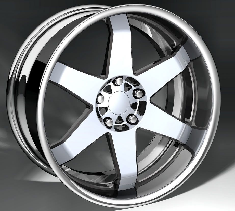

Bored at work....**wheel drawing**
here is my idea of hot! haha
I wish I could just print these bad boys out
18x10 +12 (5x114.3)
Got any input, I've got some time to kill until a client calls me back

they look pretty sick...maybe a bit too squarish for me...what color are you invisioning them in?

Looks like Gram Light 57's...

TE(motherfuckin)7/gramlight 57s crossbreed??

te37 looka likes....i like the style a lot, id change the center part.

I'm just basically f'in around in my spare time. Get bored, draw a new wheel. Not ment to mock any specific wheel, just a good look in my opinion.

Not bad, but could use quite a bit of work yet.
The concave face with lip is usually a nice idea.
It's also simple, which is good.
It does have issues that need to be resolved however.
Mainly the fact that wheel will fit hardly anything.
Not because of the size, but because of the hub pad. You have a totally flat pad which will not clear any brakes except for maybe some drums or really recessed calipers.
Add some thickness to the back of the hub pad to remedy this. This will also lower the offset, so you may have to have less lip for it to work correctly.
Another problem is how close two of your lug holes are to the windows. If these wheels were cast, you'd be worrying about stress fractures in these locations, which wouldn't exactly be safe.
The last two issues are merely aesthetic.
The first is that it simply looks like wheels that are already on the market, only with an origami form vocabulary. It looks way too similar to a Gull flame or GL 57. Try something fresh and exciting, re-invent the wheel.
The second is the origami form vocabulary.
Try adding some surface tension to surfaces and radii to edges. You'll be surprised at how much these little details improve the look of the wheel. Right now it's kind of flat, and flat has no visual interest.
Overall, nice first attempt!
I can't wait to see where you end up taking your design direction.
Keep us updated.
edit: The extra bevel on the edge of the lip is really nice.

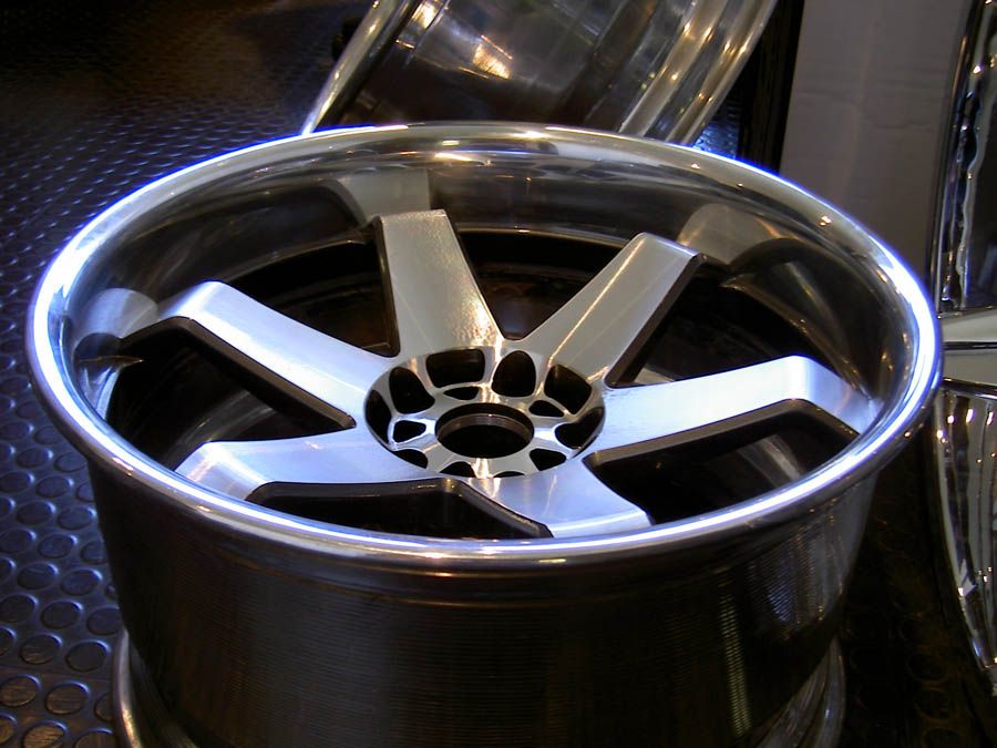

I'm the head of design at a major american wheel manufacturer, so this is what I do every day.
It's a good start.
Here's a wheel I did a year ago that's similar to what you did. Maybe it will give you some inspiration.

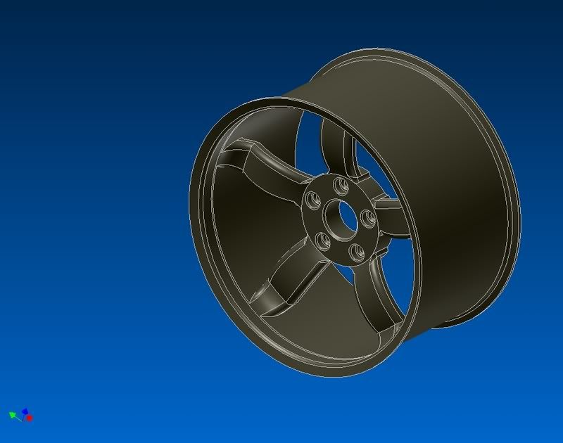

2nd attempt
20 mins modeling time....still having trouble getting the pad like I want it, still workin

Not bad.
Try making the lug area concave. It may be closer to the look you're going for.
Yuri is offline   Reply With Quote

yuri those wheels are sick, did they ever go into productions, i would certainly be inline for a set!
soon2beSIL80 is offline   Reply With Quote
Old 04-19-2007, 03:13 PM   #23
Yuri
Ghost of Zilvia past
Yuri's Avatar
Join Date: Sep 2003
Posts: 3,515
MHT Chicane.
Only one set was ever built.
Ironically, they never ended up on a car either. They're just sitting in storage.
I'll commandeer them when I get 5-lug.
Even thought there's been a lot of interest in them, they never made production. Kinda like all the cool stuff in Batman Begins.
