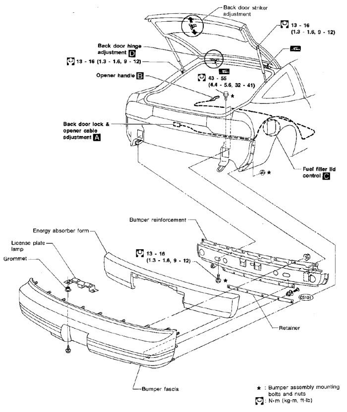

this might help
i actually didn't need to remove the rebar to take the bumper cover off, but it will be easier than squeezing in there to remove all those screws holding the bumper cover

I love the poor wording in here. There are no screws securing the bumper at all, either front or rear.
Both fastback and coupe models are the same for removal. You do NOT have to remove the tailights or lower fill panel.
Remove four bolts, size M12, in the floorboard, two on either side, under the rubber plugs. These go through to the rebar supports. Remove one more M12 bolt above the driverside towhook. Then go inside and remove six nuts, three on either side, going through the quarter panels. Unplug the liscence plate lights and pull the bumper/rebar assembly off as one piece.
Then the bumper cover can be removed from the rebar by taking off several M8 nuts.
And all this is available within the FSM, has been for nearly 18 years now, funny no one seems to know that. Everyone should at least have a copy downloaded since it's free. If you can come in here and ask a question, you can look it up just as easily.
