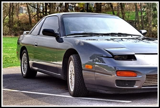

After a year or so of sitting, I decided to fire up the 240 and begin to evaluate my situation. Shortly after installing my Rocker arm stoppers there begin this ticking/clicking noise between 2500-4000 rpms. I pulled the valve cover and everything appeared to be ok. Any guesses as to whats going on, where to start investigating? I know the turbo is pretty much shot and have a replacement waitin g to go on. Heres a video of it running I made earlier, hopefully it works.
Thanks.
