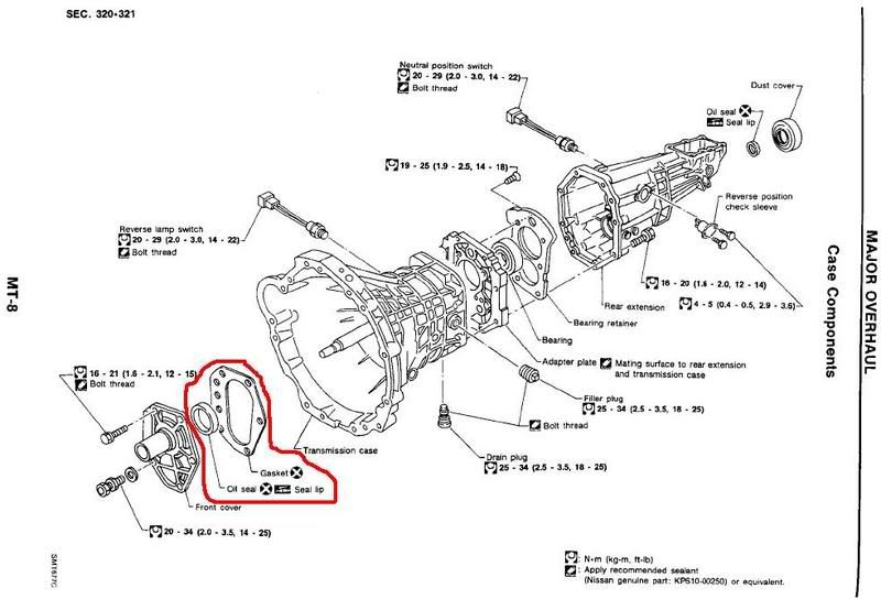

Those two are for the front tranny seal. And they go here:
For future reference the part numbers are"
32114-Y4000 for the seal, and part# 32112-08U01
What you want is the rear seal and I am not really sure what that part number is. Just call up Superior Nissan in Puente Hills or find "WestCoJustin" (I think that's his name here) and they'll hook you up with the right part.

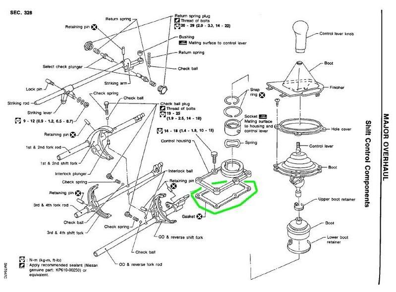

ok thx for the picture, I was looking at the manual on my computer and figured it out already.
But I think I need the gasket where the purple arrow is. Cuz my fluid leak is right under it.

what you prolly want is this gasket. Print out his picture and take it to wherever you can get a gasket from. Sorry I don't really know the part number.
