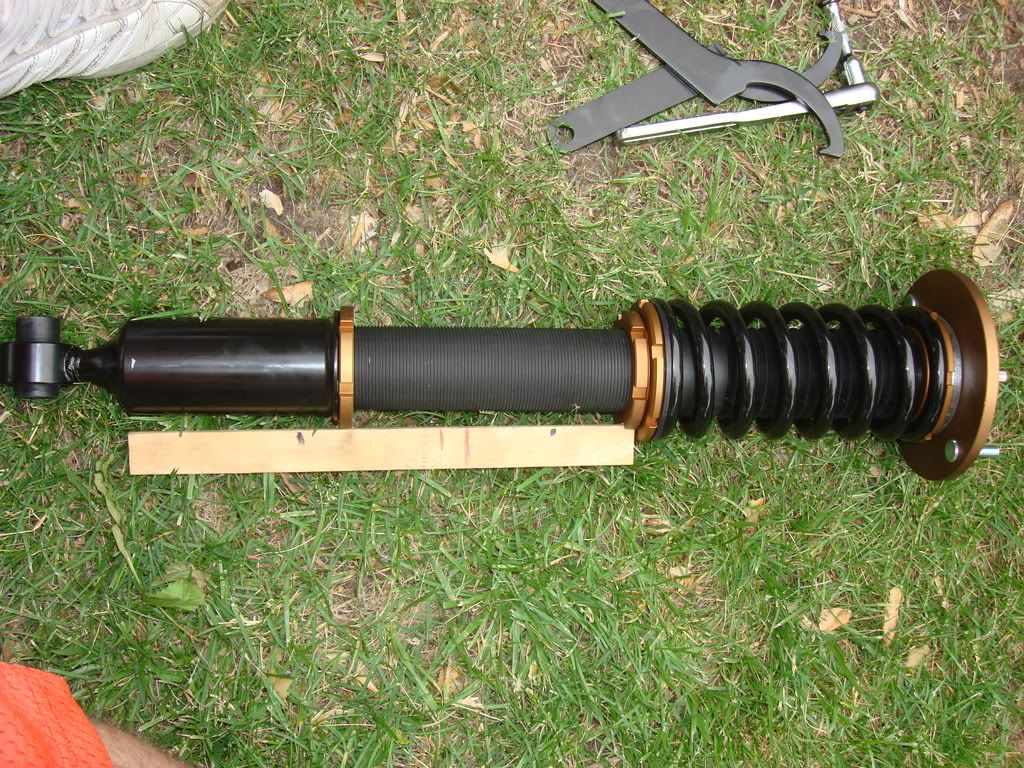

alright... so i'm trying to get the bracket to go lower on my passanger side rear which is the last thing i need to do right now and the bracket WONT go down... it's like it's stuck or something...
the other rear one would go down fine.
what could i do to loosen it up a bit? i tried spinning it while it was mounted on the strut tower as well...
idk what to do
i need it at that black dot

unbolt it from the car and change the height, thats teh easiest.
little wd40 and suchworks good too

Are you loosening the perch that locks the bracket? Spray some liquid wrench on it, works better then wd40 imo.

nevermind... thanks guys for the help... almost split my hands open loosening it but i got it... now i need to get my fender pulled so i can go lower...
