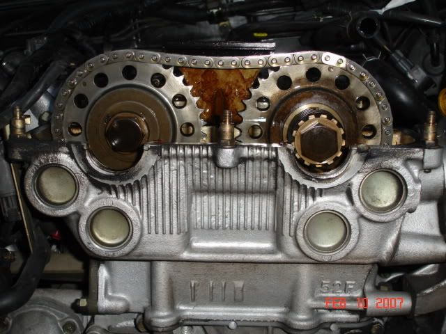

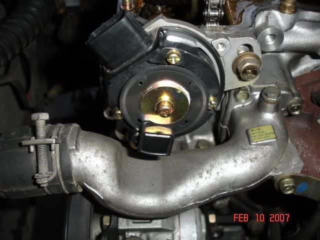

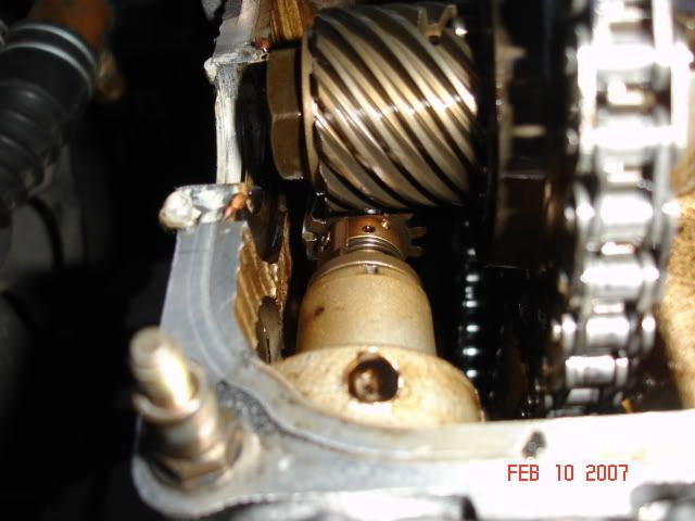

Carefully remove the cas cover and snap a photo of it.
Then rotate the engine 90 degrees, using the CRANK pulley, and take another picture of the inside of the cas.
be carefull when doing this please.

yeah, if you feel any resistance STOP!

ok guys i been working on the car all day O_o somebody please still can help me Y_Y
I check the ignition chip with the FSM and is fine, i check continuity on the harness and is ok too... i check the CAS and looks align fine to me check the pics
Crank pulley is in the 2nd mark on the left
Also check the CAS with the FSM and is ok too
i still get spark only on the cylinder 1.... i get fuel on all cylinder, i took out the spark plugs and are moisty with fuel, I also put a couple or more grounds from engine to chassis, i have check all the stuff about ignition on FSM and test it all and all seems fine
